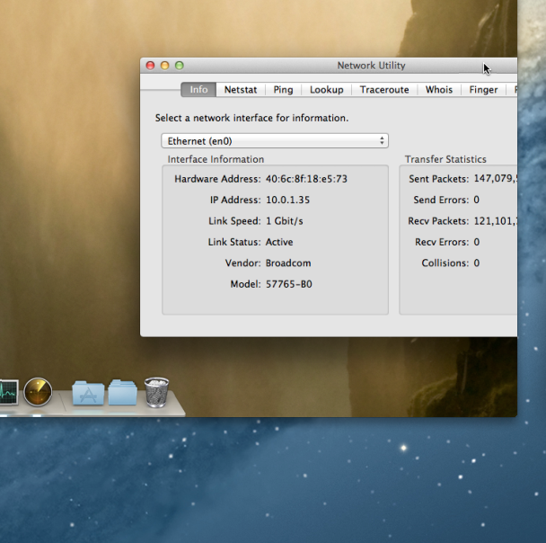

Hmmm... that should work. I have a 2012 MBA connected wired through a TB display and it is GB. Are you looking in this screen under "advanced" in "Display Ethernet" in the network panel of System Prefs?
Do you have the Display Ethernet connection at the top of the list like this so it takes priority over the wifi connection?

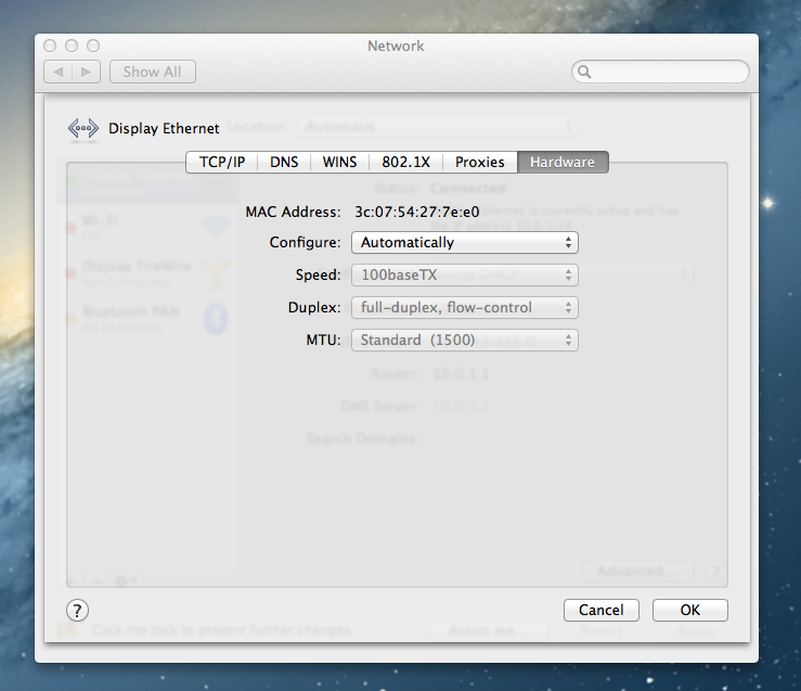

No, I've been looking in the Network Utility,
However, when I checked where you said, I see this...

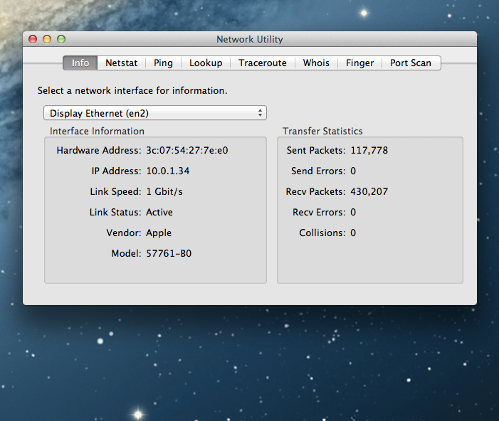

Yep, defo my cables, just replaced the thunderbolt with an old 20m Cat5e cable I had lying around, and its connecting up at 1Gbit/s. Looks like its time to change them cables up!
Just to follow this up. Ended up definitely being my cables, or more accurately, my connections.
Have just gone through and replaced the CAT6 with proper CAT6 connectors and new connectors on the Cat5e cable.
Getting a nice 1GBit/s on both the Mac Mini, and the Thunderbolt/MBA.
