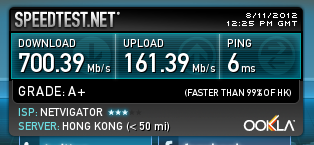

I recently bought the current generation of Airport Extreme, as well as upgraded my internet to 250M optic fiber.
However, I notice that there are major network speed loss when I connect the modem through the AE.
Here is the result of my testing:
1. Lan directly from modem to my mbp = 200M
2. Lan from modem to router to mbp = 130M
3. Wifi (Wireless-n 5Ghz, sitting right beside the router) = 70M
So to conclude, it seems there is a 70M loss when the data goes through the router, and another 60M loss when broadcast as wifi?
Is there any settings that I can do to improve the network speed? 😕

Here is an update guys. I tried a cold reboot on both AEBS as well as the modem. Now I can get 200M on LAN through router.. So LAN through router speed is the same as LAN directly thru modem.
Thanks zhenya for providing the website of SNB... I guess I haven't done enough research before buying the AEBS.
I thought the theoretical max speed for 5Ghz wireless-n is 300Mbps, so giving it a 20% loss, I thought I could still get 240M.. But in reality, it's not the case..
So is there any router that can have a faster wireless speed? Or that's the max speed for wireless-n?
