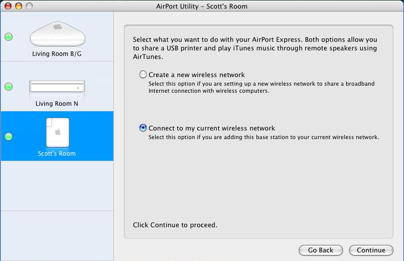

What I ended up doing in a similar situation was to reset the Express by pressing the little reset button, letting it reboot, and then using the new AirPort Utility wizard on it to join an existing network.
It did all of the setup behind the scenes. I never could get it to work trying to do the setup manually like I did before in the old AirPort Utility.

I just tried that, and it always says that it cannot detect any Airport networks. However, I do have some headway, I set the Express to bridge mode, and matched the wireless settings with those of the Extreme, and now the Express has a green light, but I dont think I am getting a signal off of it because 1) The signal strength is the same (60%) even if I hover the Airport Express over the laptop. 2) There is very little activity coming from the Express 3) The Extreme logs two clients (my PowerBook and the Express) but the Express also logs the Extreme as a client.
