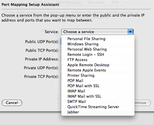

well the ip, i know and port i should be able to figure out but then under airport, i dunno which of these options to chose from.

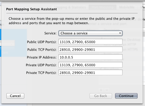

I don't own one but it looks like you leave the service option blank, then set the Public & Private UDP port to 13139, 27900, 65000 and TCP port to 28910, 29900-29901 then Ip address to the computer you what it directed to.
You may have to make more than one rule for each port option i don't know how the router works.

It's really irritating – I've opened up exact these ports and it still won't work. Not with the AirPort Extreme I had previously and not with the Time Capsule I have now. Games can be joined but not started. It seems the latency is to high.
What is it with this game and the Apple routers?
Or what am I doing wrong?
This is how it looks for me in the Port Mapping:
Seems right, or?
Have you changed your AirPort's default IP address and range? It's supposed to be 10.0.1.1 for the AEBS and 10.0.1.XXX for all other devices.
