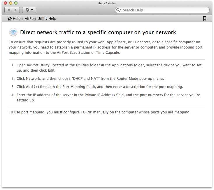

Have you had any luck with what the manual says?

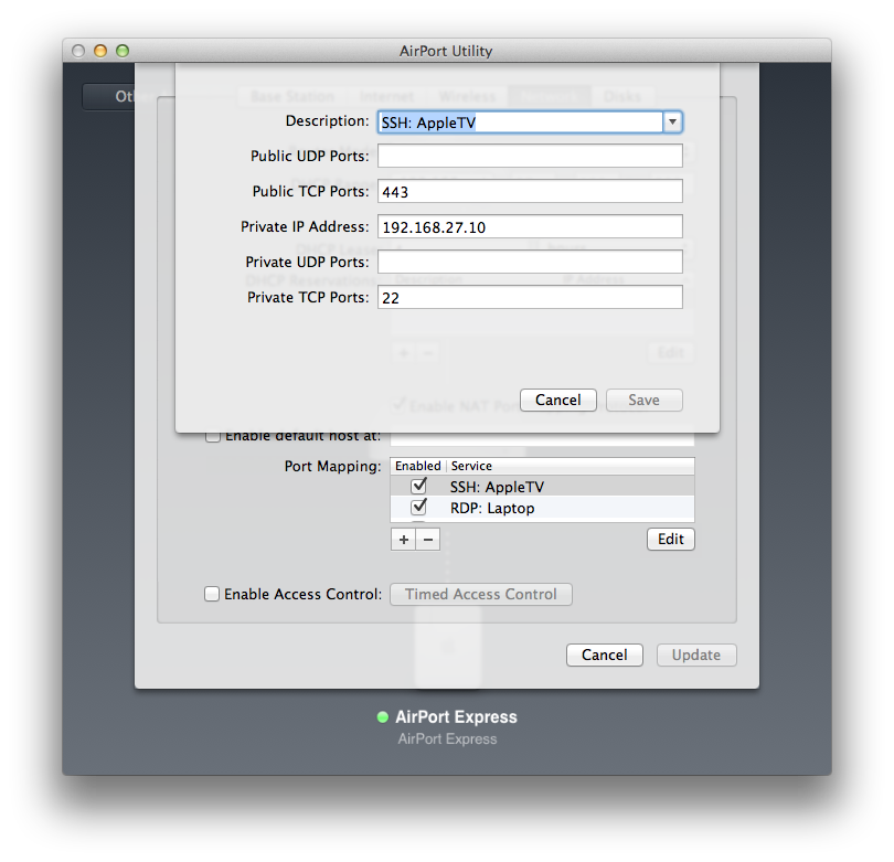

Hmm. I have TCP port 443 forwarded to port 22 of my jailbroken Apple TV and both of the test sites you've listed work OK for me. 😕
Your setup look like this? Port 80's really commonly blocked. Maybe try 443 as a test?
