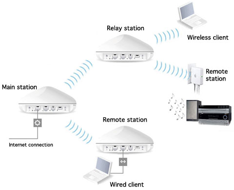

I'm going to assume that English is not your native language. Apple has several great articles on how to design and implement AirPort networks.
Basically, you are going to want to design your wireless network like the diagram below.
Check out the following link for more information:
http://manuals.info.apple.com/en/Designing_AirPort_Networks_Using_AirPort_Utility.pdf
Link for older AirPort Extreme Base Station WDS configuration (with better diagram):
http://docs.info.apple.com/article.html?artnum=107454
On an additional note, you are going to want to reset all of your base stations (AirPort Extreme Main Base Station, AirPort Express, etc) to their default settings by holding down the reset button (on the back) with a paperclip.
I've had better luck letting the AirPort Utility program automatically configure WDS instead of trying to manually do it. However, if you need to setup a "relay" base station, you must manually configure.
