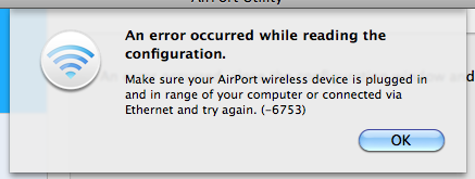

This is the message I get when I open Airport Utility:
I hit continue, it reads the Airport Extreme configuration for a few minutes, then it says it cant recognize it.

From reading the manual, it should be a solid color. Plus, if what you said was true, then why would I be getting that error message? I think I might have did something wrong in the setup, since I chose manual setup, but I dont know 😕

Also, I keep getting this error when I try to access my airport extreme. This is EXTREMELY frustrating. I did a hard reset when my original post was posted, and airport utility got me into the settings, and it worked fine. Now nothing. Am I going to have to hard reset every time just to get this to work properly?
