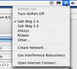

My roommates laptop and my Tivos are all 802.11g (with no easy way to upgrade to 802.11n), so I setup two networks (using my old 802.11g router, which was also an Airport Extreme).
The cable modem plugs into the WAN port of the 802.11n Extreme.
I have that Extreme set to a 5ghz 802.11n-only network.

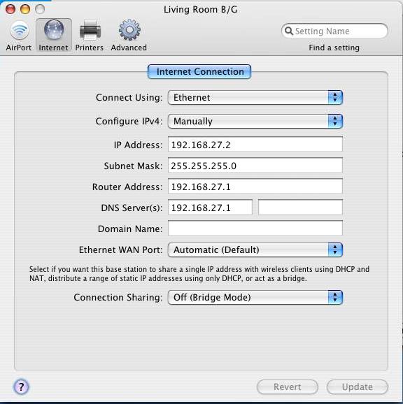

I have a CAT5 cable running from one of that Extreme's 3 ports over to the *LAN* port on the old 802.11g Extreme.
I have that Extreme set to "bridge", which basically tells it not to assign IP addresses to devices that connect to it. (It lets the request pass back up to the 802.11n Extreme which does all of the DHCP).
The end result is you see two separate networks at my house (Geh Weg x.x), but they both will get you on the same 192.168.x.x network (so devices on either network can talk to each other just like if it was one network).
