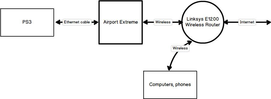

I'm trying to setup an Airport extreme to serve a single function: Route data through a wired ethernet cable to and from linksys wireless router that's connected to the Internet. The airport extreme needs to connect wirelessly to the linksys router.
Here's what the setup looks like:
I've tried combinations of "join a wireless network", "extend a wireless network", bridge mode, etc... but I can't figure it out. As I said at the start the Airport purely has to route between the PS3 and the wireless router, nothing else. It doesn't need to allow any other devices to connect to it.
The reason I'm going for a wired connection from the PS3 is that it's Wifi is atrocious and the only way I've gotten decent speed out of it is with a wired connection.
Any guidance on how to get this setup to work?
Here is your problem. What you are trying to do is use a protocol called wireless distribution system (WDS) to extend the network wirelessly. The Airport Extreme supports this feature but your E1200 does not.
You will need to buy a router to replace the Linksys that does support WDS. I have found WDS works best among routers of the same brand. My suggestion would be to move the Airport Extreme where you have the Linksys now, then get an Apple Airport Express to extend with WDS.
You can get a refurb previous gen Express for $69.
Thanks, you put me on the right path. To resolve the issue of the E1200 not supporting WDS, I flashed it with DD-WRT. I got WDS working but for some reason the wired connection was running slow. So instead I switched the Airport Extreme to be the box connected to the internet and the Linksys to be the one accepting the wired connection. I then changed the Linksys to operate in "Repeater Bridge" mode rather than WDS. And I have it connecting wirelessly to the Airport. Now it's all working quickly.
