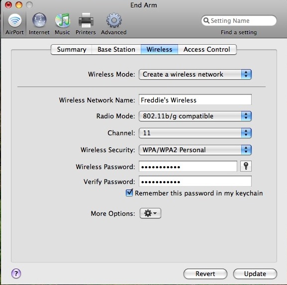

I think you might be a bit confused. To stream music wirelessly you need the Airport Express not the Extreme. I believe you can connect the Ethernet jack on the Express to your Uni's jack and use the Express as an wireless router. This will allow you to secure the shared printer and music. When you set it up make sure you select create a network. Also you should enable WPA2 on the network to make it secure. If I have time I'll show you how you should setup your Express for want you want.

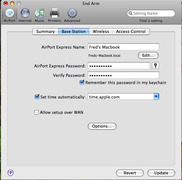

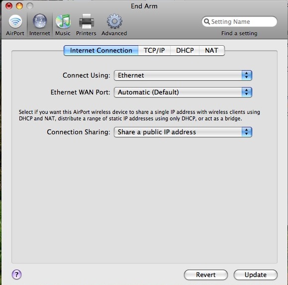

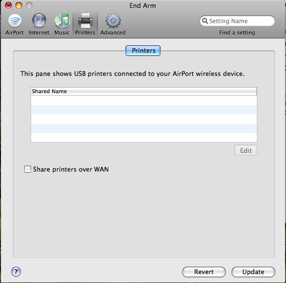

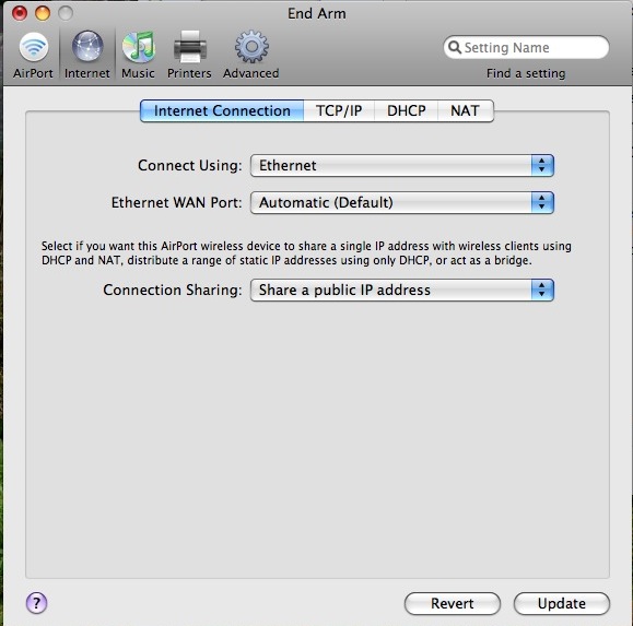

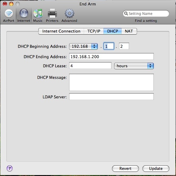

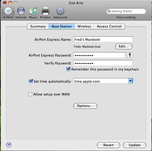

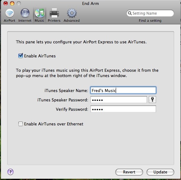

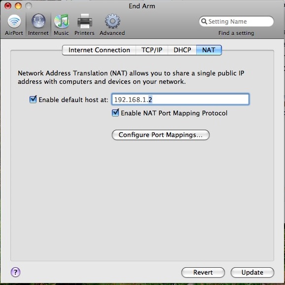

That's when you put your laptop outside of the NAT. Here's how I think you should setup the Express. In the fourth image in the 192.168.1.2 make sure you enter your Macbook's IP address after it has been connected to the wireless network.

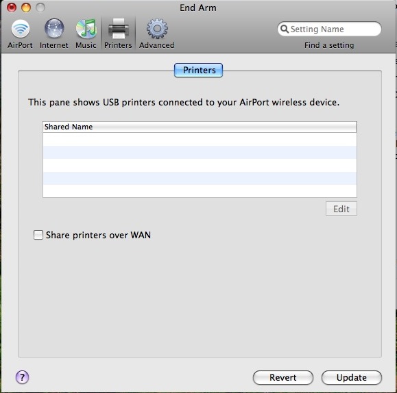

Setup continued: In the Printer tab you'll have to setup your printer. Also don't forget to fill in the password boxes with good passwords. I used the name Fred as a place holder for your own name. It is not my name.
