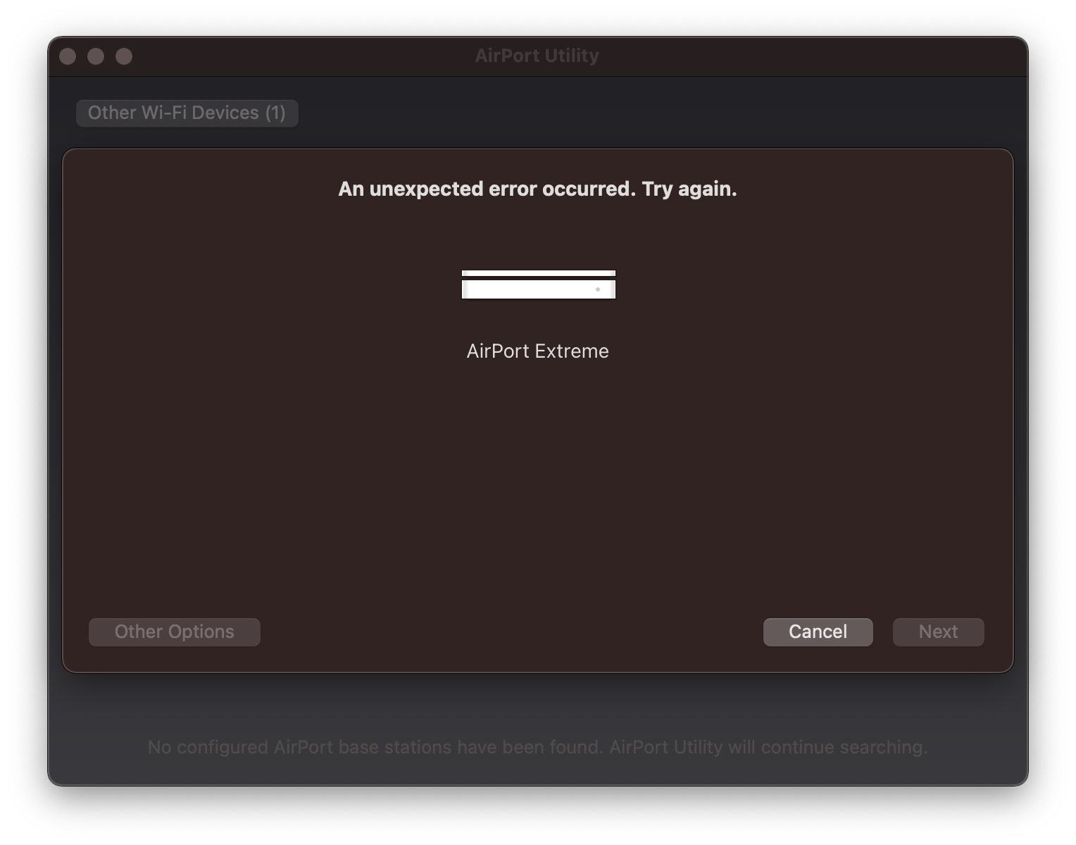

I got a used AirPort Extreme (5th gen.) as a replacement of the missing internal AirPort in G5 Quad. Unfortunately, for some reason it fails to be configured properly. I wanna know what can be tried, since device itself appears functional: it starts up and is recognized after reset both over WiFi from MacBook Pro and over Ethernet from PowerMac. Firmware is 7.8.1. The problem occurs after setting it up to connect to existing WiFi network: once set up, it is no longer seen in AirPort Utility (over WiFi and Ethernet alike) and internet does not work when it is connected over Ethernet to PowerMac. AirPort Extreme itself behaves as if set-up has been successful: green light is displayed. But for both Macs it just “vanishes”.
Upon reset it returns to original state, orange light, and both Macs can see it as unconfigured device. Attempt to configure it again fails in the same way. I have tried factory reset, to the same effect.

On PowerMac I get option to join existing network, but it does not result in a working set up.
On MacBook Pro I get only Extend network choice, and once I set it up, Airport Utility displays an error device is inaccessible afterwards (so I cannot modify any settings, only reset the device), even though it displays green light as if it is set up.
I cannot figure out how to reach the screen show here: https://discussions.apple.com/thread/7361999
