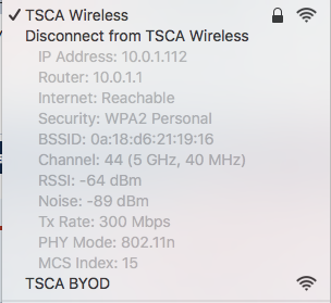

How can you check what speed 2.4 v 5 you are connected at?
Option click the Wi-Fi icon on any Mac running OS X. It will show under the "Channel" field.
