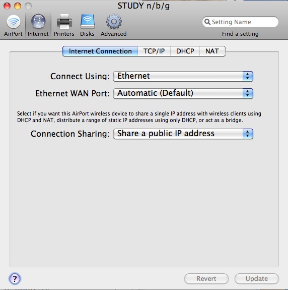

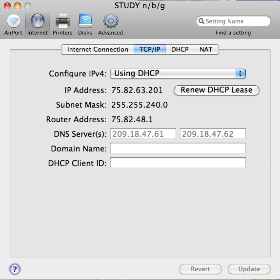

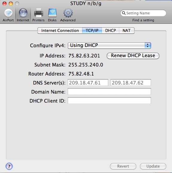

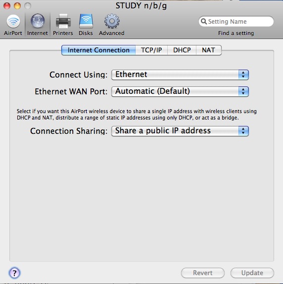

Good to know that you're working off of a cable modem, because I switched from DSL to Cable just this week. When everything was first set up, we had the same problem - could connect to the internet if modem was directly hard lined to my Computer, but not when it was connected to my Airport Extreme Base Station(AEBS). I did some research, and found some info on the subject.
Most Cable modems, are what is called a "dumb modem". This means that the modem will only recognize ONE "master", so to speak, and in this case it is your computer. Once it goes from computer to AEBS, it will no longer recognize this "new" master. The ONLY fix that worked for us, and believe it or not, this did the trick:
Power off EVERYTHING - the computer, cable modem, Airport Extreme AND, here is the important part, you must disconnect each of these components from their electrical source - pull OUT the power cords. Leave everything in this state for a few minutes - NOT less than 60 secs at the very least. Then, connect them again to the AC, and do a HARD reset of the AEBS. At this stage connect the modem via ethernet to the AEBS, NOT your computer. Power them on only one at a time. So, say the AEBS is first , then power on the modem, then the computer.
Now open Airport Utility. If your computer does not "see" the AEBS, connect it (NOT the modem), via ethernet to your computer to do the configuration. It should like like this:
The above totally worked for us, setup after that was smooth as silk, network is just fine. Give it a try.
