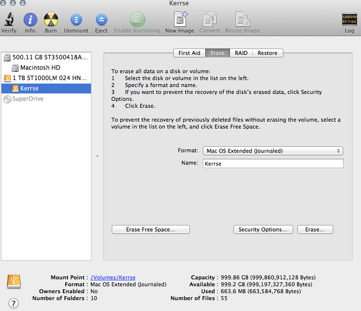

How is your drive formatted? It may need to be HFS+ if it isn't so already.
That does seem strange that the ATVs are able to access it but your iMac isn't. That's what makes me suspect the filesystem of the drive rather than a power issue.

It was a lot of movies so had to transfer them back as I had deleted them from the mac to create space everything else's on there was just back ups I'm not running the drive as time machine just manually updating it as its mainly to run as a network media drive
I have taken a few screen shots maybe that can help solve this as i am baffled
