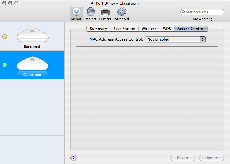

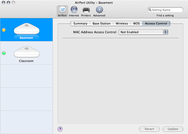

Really weird then... Is anything listed in the Access Control tab of AirPort Admin Utility for either base station?

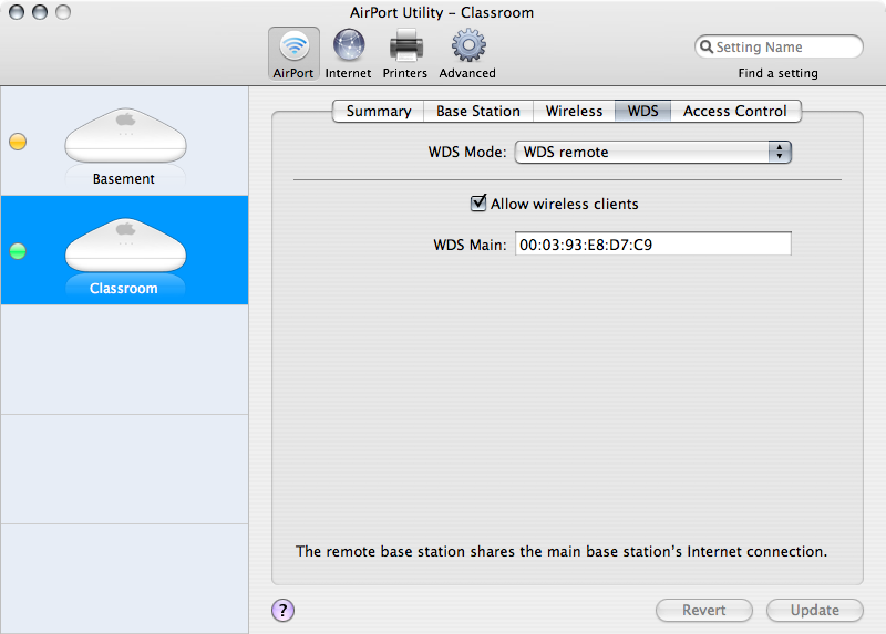

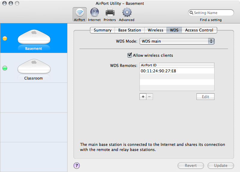

Mate, would you mind taking a screenshot for us. The primary station is the one I'm interested in. That's the station connected to the modem.

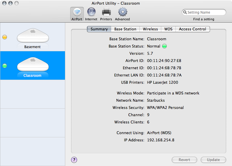

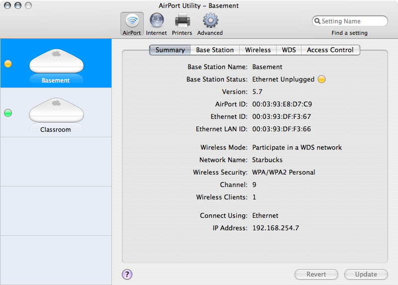

Here are screenshots of most of the Windows available in the Utility.
Something that has been like that originally is the "Ethernet Unplugged".
Also, not sure if this means anything, we were told to use the router in the DSL modem rather than the routers in the Airports because otherwise they fight each other.

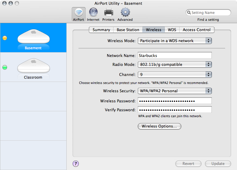

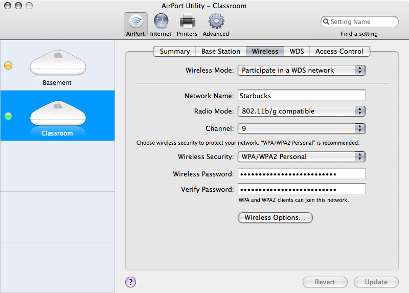

Here are the same pics but from the OTHER Airport.
