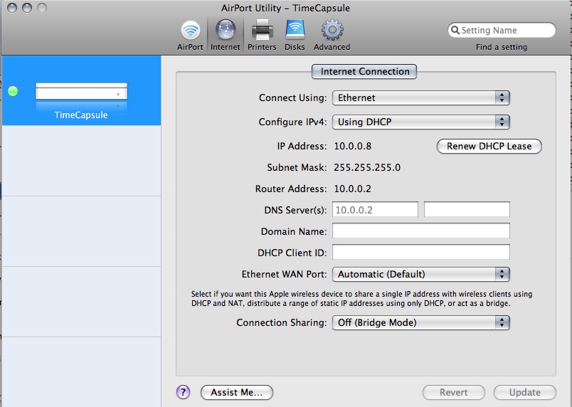

I had a very similar issue with connecting a Time Capsule to a modem (so I'm not sure whether my solution is applicable to Airport Extreme - but here's hoping). What worked for me was selecting Bridge Mode under Internet > Connection Sharing. See pic.. Once done, switch off both devices, then on again, your modem first.
Thanks, I tried this but had no luck. Any other suggestions?
