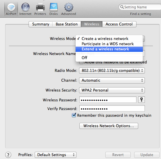

I would also recommend downloading AirPort Utility 5.6 to use with your new AEBS. The newer version has been iOSified and Apple stripped out just about all functionality from it.
Here is where you would set up bridge mode.
