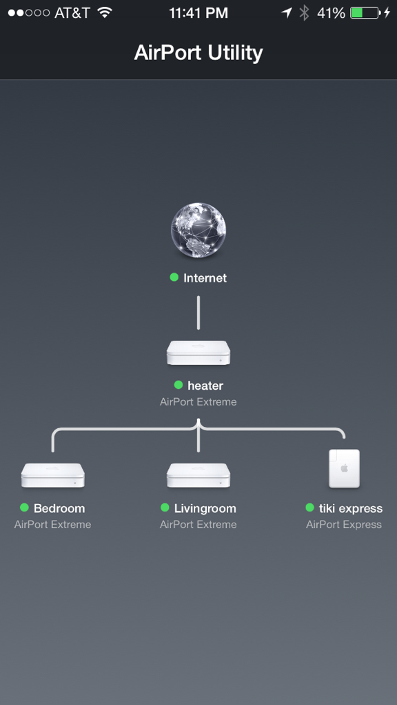

This is the current setup
We got the 5th Gen extreme at the top under one network name, and under it's wireless options the 5GHz network is checked off with a different network name. The then 3 expresses at the bottom are spread throughout the house, under the 5GHz network name. (never mind the one on the right, it was green until I messed with it before screens hotting). I got one of the expresses in my room, but when I connect my devices such as the Apple TV to it, it very often gets interrupted and says I have been disconnected. When I switch to the extreme under the regular network name, it is slow and not capable of streaming HD for example.
So the expresses are just connected wirelessly to the extreme?
If that is the case then you are losing a lot of your speed. While the express can connect wirelessly to the extreme and extend your network range it also drops the speed big time. If you have to have all the expresses to cover your apt. and you want to keep the speed of the network up then you will have connect the expresses via ethernet.
So you are going to lose throughput when you extend your network wirelessly like this. However that shouldn't stop you from streaming HD.
You mention one of the expresses is in your room with you, where you are then trying to connect to it with you Apple TV. You really don't want your wireless extender where you want to use it but where the main Airpory Extremes signal is strong...
Think about it like this. If only using the Extreme the signal is week in your room, then adding an express to your room isn't going to boost that signal because it is still receiving the crappy signal. What you want to do is put it half way between you and the Extreme. That way it has good signal to repeat and send into your room. Make sense??

I did not think about that at all. That may be the issue in all of this. Still doesn't explain the interruptions in connection from the Apple TV, unless that happens because of a weak signal. Also, is "join this network" the correct option as opposed to extend this network?
Joining a network makes the Airport connect as a client. This is suitable for Airport Express routers being used strictly for AirPlay. It does not add more range to your network.
Setting the secondary routers to "Extend a network" will allow them to act as a wireless base station. Since they have to repeat the signal via wireless your throughput is cut in half.
Yes if the express is dropping the signal to the Extreme due to quality then you would see that in your Apple TV
No you want to "Extend" http://support.apple.com/kb/ht4259
