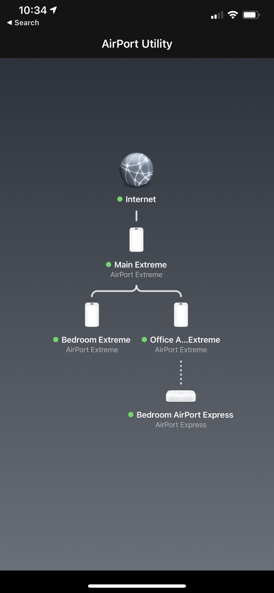

I have three AirPort Extremes and a airport express for my network at my house and all work great and would like to keep them except one part of my house I need faster Wi-Fi speed. I was wondering what router I can add to my network that will work with my airports and not be a pain in the @$$ to configure any ideas will be helpful
The express is wirelessly connecting to the network. This results in WiFi bandwidth being split between the Express uplink to the network and clients. It tends to slow all wireless connections.
First thing I would consider is hardwire connecting the express.
Then, look at your placement of the devices, you may be able to improve things by moving Airports around a bit to fill gaps.
Most homes can operate with just one or two access points. Exceptions are really large homes, and homes with dense interior walls and floors (brick\block, steel). Too many access points can actually slow things down as the airwaves get saturated with signals.
The Airport utility on iPhone has a WiFi scanner built in, enabled in Settings, then activated in the Airport App. U?se that to gather info about your signal strength and competing signals.

Yes I know the express is going to be a lot slower because it’s wireless. I have good coverage everywhere but that corner of the house but it is rarely uses so I can live with the drop in speed. What I need is for the area covered by the bedroom extreme to have higher throughput. As there is a considerable amount of devices connected to it threw Wi-Fi. including my main work laptop and I need faster Wi-Fi speeds. I was thinking about a ax router to replace it but just wanted to add it into the network. Is there a router that will just drop in to replace that extreme. But give faster speed?
The thing with a wireless connected Express is the uplink may be to any of the Extremes, whatever happens to have a stronger signal at the time. But, regardless, wireless bandwidth is compromised when you "extend" wirelessly with Airport devices. Signal strength can fluctuate as interference from all kinds of wireless devices, neighbors networks, radar, microwave, wireless home phones, on and on. The number of Access Points you already have may be trouncing on each other too.

I just added the express in the back corner of one room that wasn’t getting the best speed. Today I ran a cat6 cable to it threw the wall and ceiling to have it wired. No no matter wher I go I have coverage and no matter what I do I can’t get over 400Mbs over Wi-Fi. A lot of my devices are Wi-Fi only and my lap top I’d like much more than that. I pay for 1.2G and I can get that on my hardwired computers but nothing close to that Wi-Fi. I don’t need that speed except I’m one location where I use my laptop. So how can I keep my setup I have now but add a newer router into the mix so I can get faster uploads in one particular area?
Again, WiFi is prone to interference. You will rarely get speeds matching ISP service levels over the air, particularly with AC routers and Access Points. 400Mbps is actually pretty good for WiFi performance. When you really need fast downloads, use wired connections.

My networks are “apple” “apple 5ghz” and my speeds posted are on the 5Ghz network. I think I’ll go the way of keeping my APE as routers but turn off the Wi-Fi and add Wi-Fi ax access points. That should do the trick?
