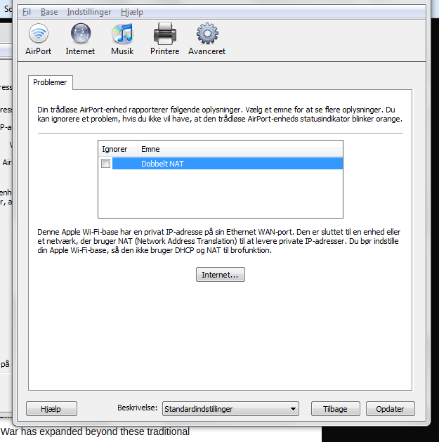

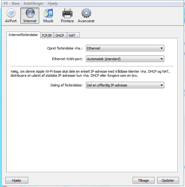

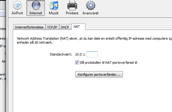

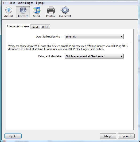

When a choose to share a public IP adress it asks for NAT standard host (10.0.1.?). Shoud i type in anything here?
If I click update without typing in anything it says that there has been detected a problem - something aboub double NAT: "This WiFi-base has a privat IP adress on its Ethernet WAN-port. It is connected to an unit or a network which is using NAT to deliver private IP adresses. You should configure your WiFi-base to not use DHCP and NAT to bridge-mode.
Double NAT is fine for this. Does it work in this configuration?
No. With this configuration neither pc or iphone are able to connect.

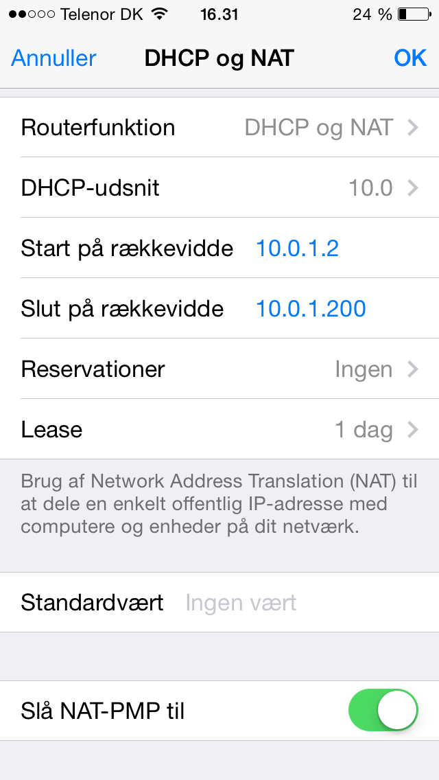

Try setting this up using the mobile AirPort Utility on your iPhone. Then just set it to DHCP and NAT mode. Begin by factory resetting the AirPort and reconfiguring it with your phone.

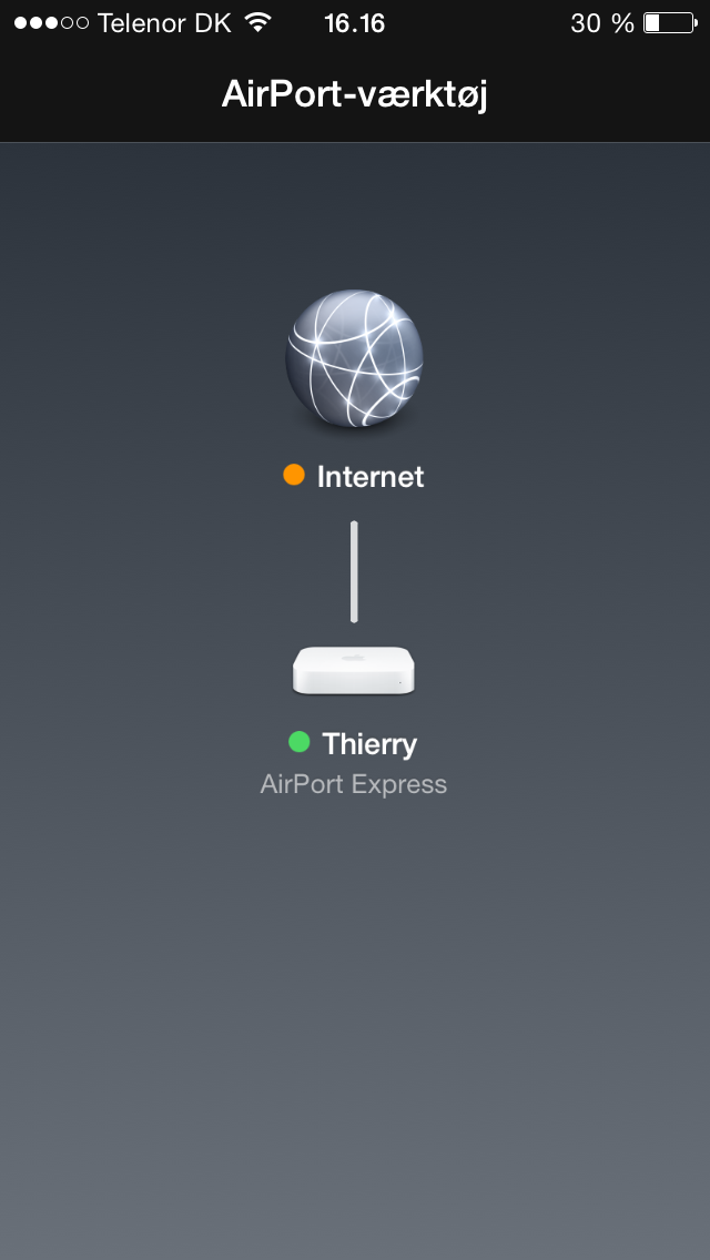

I have tried to reset the Airport and reconfigure as DHCP and NAT with the iPhone utility. It connects to the network but there is no ethernet connection.
Try rebooting the ISP provided modem to get it to relink with the AirPort.

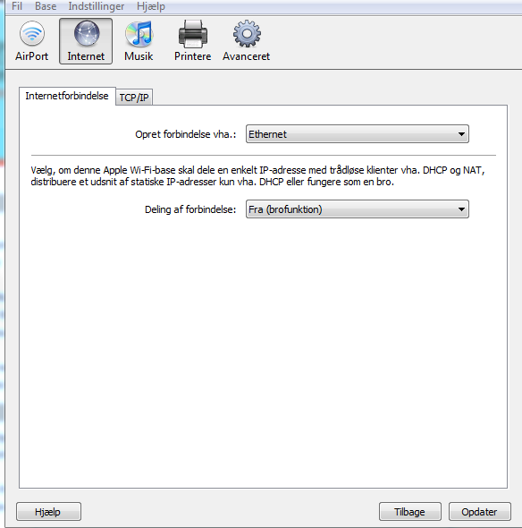

Under the Internet tab in AirPort Utility does it list DHCP?
Right now it is in bridge-mode so DHCP is not listed.
If i change to ""share a public IP adress" or "distribute a range of IP adresses" it is listed. In public IP-mode NAT is listed also.
This should work with DHCP on in the Airport and set to distribute a range of address like the default setting.
