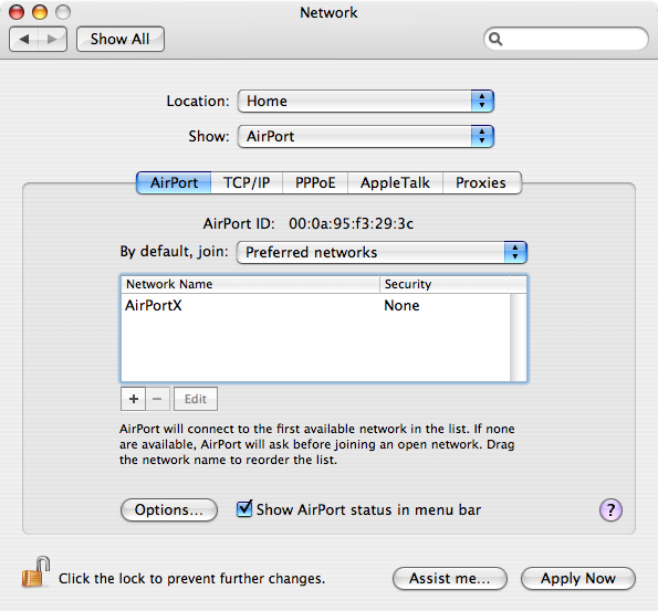

    You should try to set up different locations for 'home' and 'work' and not just have it on 'automatic'. On the list of networks it will only join the one wireless one on the list (this is on Tiger, might look a little different on Leopard).

    ok thanks, i will try to set up different locations and see if that helps. the thing is, if i keep trying and trying and trying, it eventually connects. or if i ignore it for a bit, then it finally connects eventually. does it have anything to do with signal strength maybe? but its almost at full bars...
