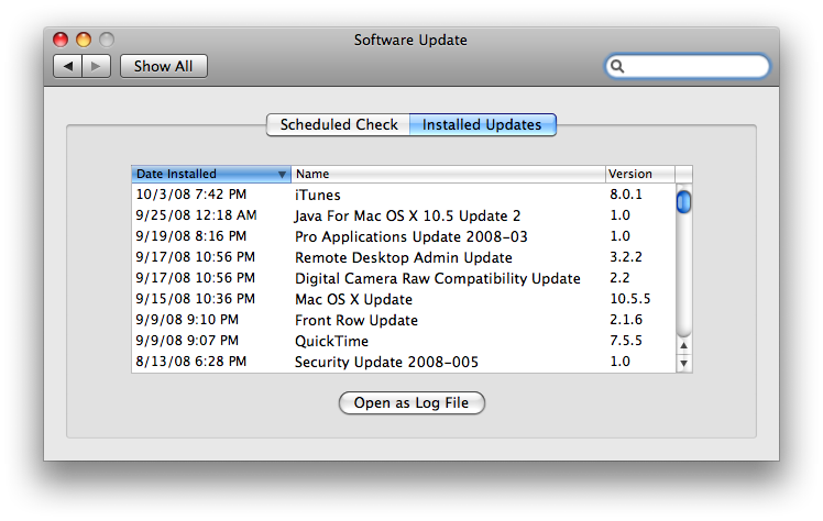

Another question, is there a way you can check what you've recently installed through Software Update?

If you want to check your "log" of Software Updates:
>> Sys Prefs >> Software Update, choose "Installed Updates", and sort by date.
See pic.

edit: Thanks for the software update tip. It was the latest security update for OS X and an image viewer update or something in addition to the other two I listed.
