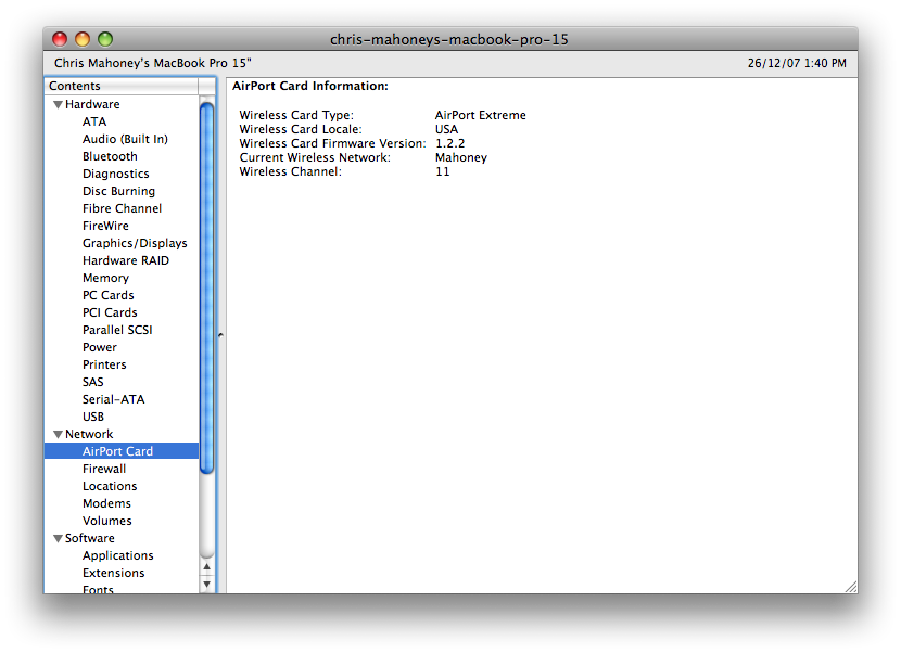

Alright so i upgraded my airport in my macbook pro to wireless-n a few days ago... perfect, nothing went wrong,very easy install. but then i was near a wired ethernet cord, just plugged it in overnight for reliability(for downloads)- and when i disconnected it and went to turn my airport back on, it was off and i could not click anything. dont even know where to start- help please

it definitly worked- perfectly, it still is there in my hardware- it just says it is turned off... i dont get it
