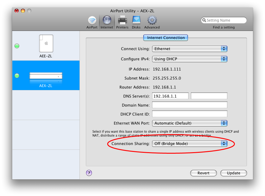

What does the IP address say in the Internet Tab on the APX? Do you have it in Bridge mode or Share an Address mode?

You have to use bridge mode in the Internet tab.

Didn't work, I don't have that bridge mode I am using an Airport Express
