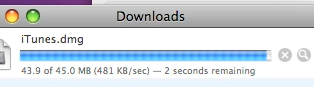

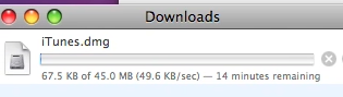

Ive had this problem with airport on my macbook since updating to 10.5.2
Basicly if my macs been powered down and i start it up when i download someting the maximum speed i can gat is about 60 kbps:
attachment.php

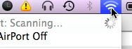

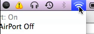

That is untill i click the airport icon in the menu bar and wait for it to finish scanning:
attachment.php
attachment.php
Then the download speeds are back to normal:
attachment.php
I was hoping the airport update yesterday would fix it but it didnt.
Does anyone else have this problem and you do does anyone know how to fix it?
Thanks
