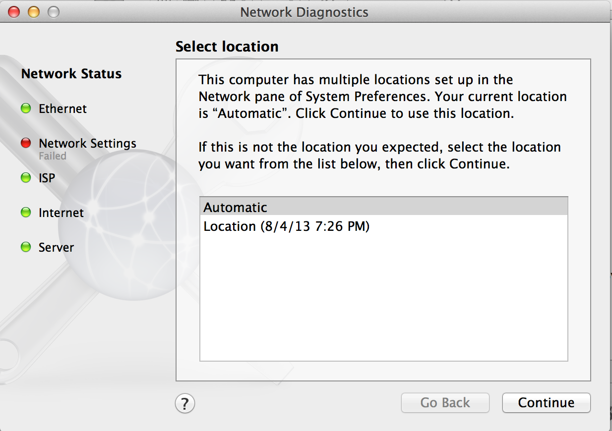

So I set it up today and I am a bit confused at what is going on.
All seemed to go well. But every so often it seems like it stalls as it is trying to reach the internet. Then all of a sudden it connects and it is fine. It is like when I first go to use it for the first time.
The other problem is when I go to Network Diagnostics.
For some reason everything comes up with the green light accept for Network Settings. That comes up failed.
Any advice/suggestions?

I am connecting via a Cable Modem. It also seems every time I open the AirPort Utility the internet light is yellow for some reason and when I highlight internet it says disconnected, then it becomes green. I have my MBP connected via the TB Ethernet connector.
I have tried restarting the cable modem. There are DNS entries.
This is what I am seeing now.
EDIT: And the internet keeps freezing and then starts working. So frustrating.

And why does this keep happening?
What's the error (it shows "1") when you click on the TC?
You are pulling DNS and an IP from our ISP router and it is disconnected? The only time I have seen that was when the ISP its self had not acutally activated the service at their end. Did you check with your ISP?
Also, are you sure you have the right connection setting in the intrenet tab? I am assuming it is DHCP as you are connected directly, but some direct connections can also use PPPoE even if it is not ADSL. If it is PPPoE you will need to input your user name and password.
Unplug the modem and TC for about 5 minutes, disconnect the ethernet wire from the TC. Let the modem completely reboot, then plug in ethernet cord into TC and plug in TC. Let it completely boot.
