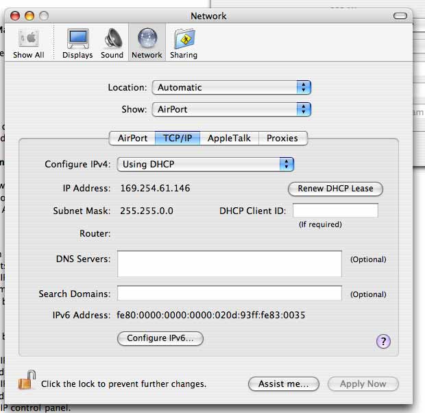

I have attached an image showing the IP settings that appear when it "connects": (networksettings.jpg) My IP address is 169.254.4.249, however many of the Apple documents say it should be 10.0.0...etc.

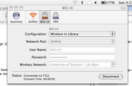

I have also attached an image showing the internet connect 802.1x settings where it has connected but will disconnect after a few more seconds: (internetconnect.jpg). Note that the AirPort menu item contains NO bars of signal.

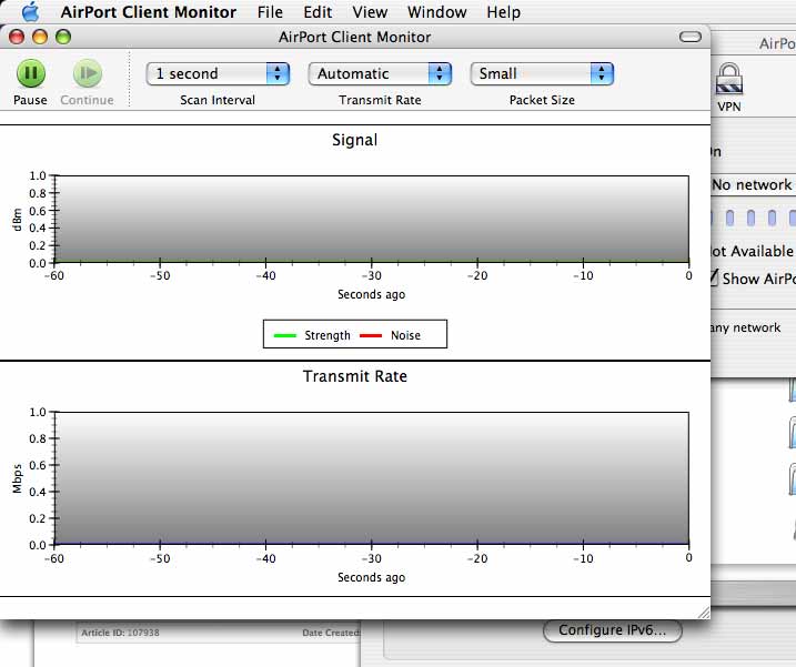

In fact, if I have the AirPort Client Monitor running, the signal is very weak along the bottom: (signalmonitor.jpg). Note the green and blue lines at the bottom of each of the graphs.
