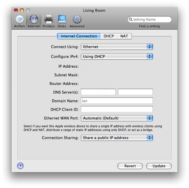

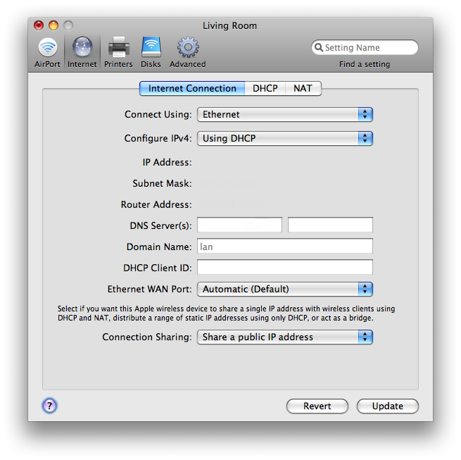

It seems your dorm isn't doing DHCP and is only distributing 1 IP address which can only be used by 1 device. To get DHCP connect your dorm ethernet to the WAN port (first port NOT the generic set ethernet ports) on the back of your AEBS
Then make sure your settings are as thus, save settings and things should work. If not consult the dorm's IT admin

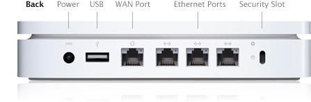

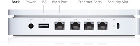

Yes you can. Connect an ethernet cable from said jack to the WAN port

Read carefully..he's got an Airport EXPRESS, not and extreme. Thus no WAN port.
Well there you go...i was reading this late at night and must've missed it. Still though, the principles should be the same. Connect from the jack in your room to the jack on the express and use DHCP on the express
