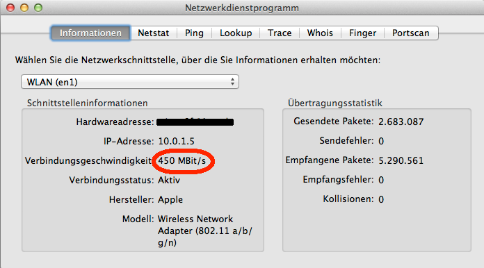

Thank you for your response. I am not really sure what you are asking so here is a screenshot :) So does that mean that signing up for a faster internet plan will not have any effect on wifi speed, I will get the boost only when connected via cable? Thanks.

Monitor your RSSI. An RSSI of -76 is not that great. You want closer to a 0 when you are working with negative numbers.
Even when I am sitting right next to my AirPort Extreme, I only get a -29. The furthest portion of the house from it, offers me a -65.
Wireless is finicky. Having designed a few networks in my career, many things can interfere which you cannot even see. A microwave, a refrigerator, a wireless home phone, horse-hair plaster walls, lead-based paint... I can go on.
Depending on the age of the house and whether it is a multi-tenant unit can affect the way your wireless works.
Mine also shows a Link Speed of 270 and a transmit rate of 216 a majority of the time. Sometimes the transmit rate will bump up to 243, but typically, it is always 216. Compare your RSSI with the transmit Rate. If the negative number get "larger", then your signal is getting weaker.
If you feel that you are getting a slow response, change your channel to 149. Not many devices default to it so it may minimize any interference you may have with competing 5GHz networks.
Oh, and your wireless network and any devices in between your wireless access point and modem may still be the limiting factor whether you can increase your Internet bandwidth. This can be due to any inefficiencies found in consumer grade electronics. If you move to business grade electronics, things DO improve on your local network, but I doubt you would want to deploy a $1K wireless access point, $2K Gig-E network switch, and a $3K network router in order to see this improvement. ;)
