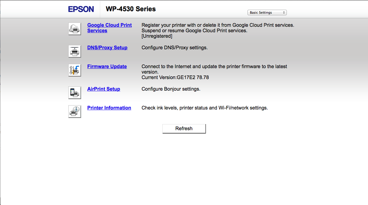

What?! AirPrint doesn't require any configuration. Just plug your printer into the network and your iPads / iPhone / whatever will see it.
There's an option to configure it, whether it actually does anything is a mystery. Could be there for novelty.

Maybe the printer still has the old static IP from the other router. Can you ping the printer's IP? Did you know all IP based printers have wiki web page? Just put that printer IP in your browser address bar and you will get an web setup page.
I got it, from there you can change the name Bonjour uses to ID it on the network. Instead of having WP 4350 you could have Barney's Printer.
