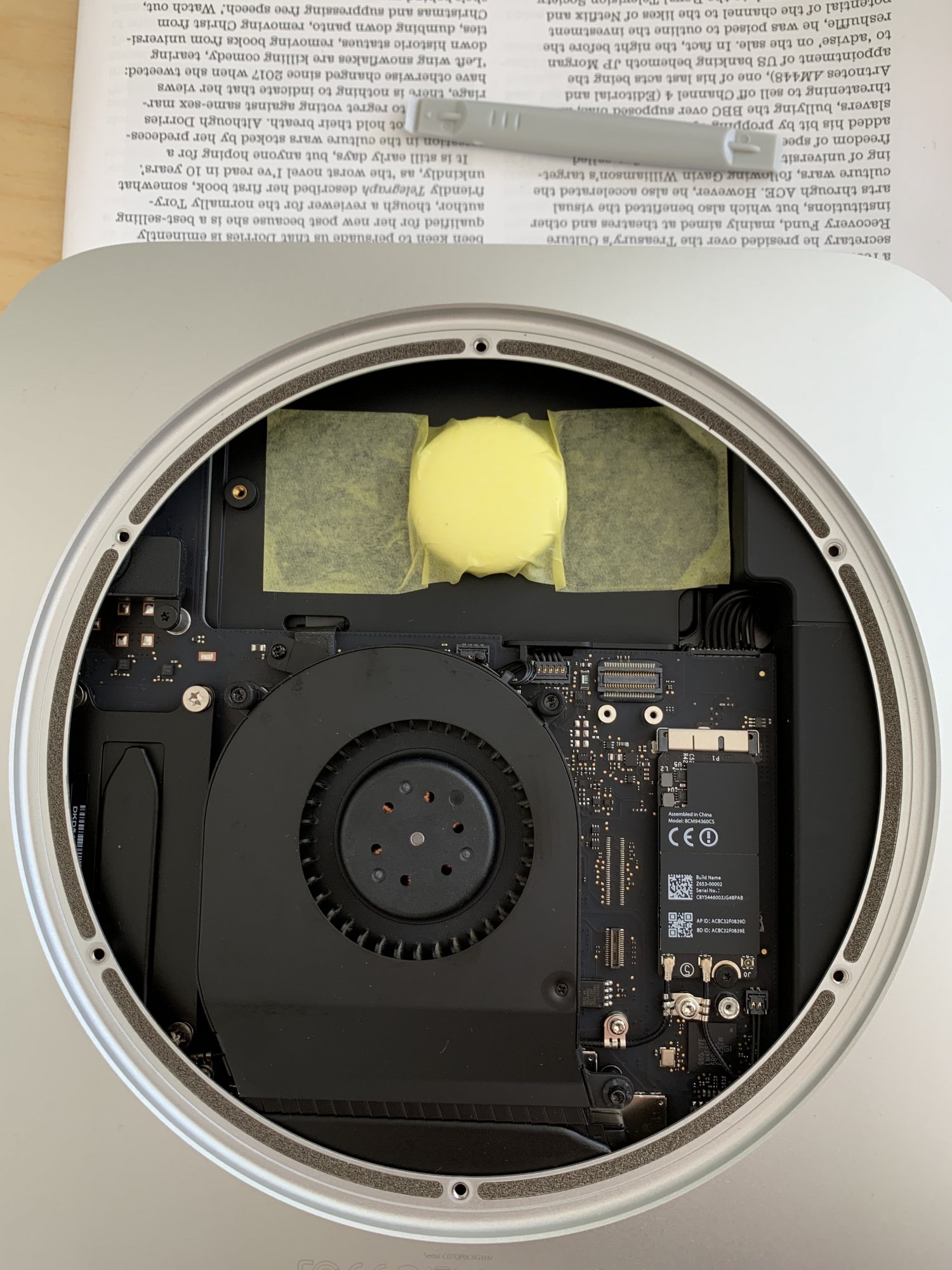

For future reference, an AirTag fits in fine where the PCIe SSD would go. Lots of room.

I would be worried about the metal enclosure of the mini blocking the signal from the AirTag. Judging by your picture you've already got it setup, any info on how well you were able to connect once it was all closed up?
The plastic bottom should pass the Bluetooth but it won't be strong.

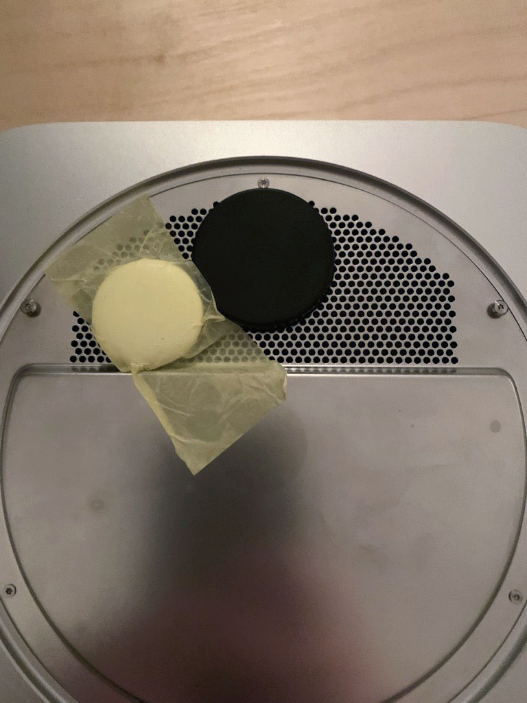

Yeah I actually had to revise it after a day or so. Even though there's the mesh of holes by the airport antenna, it was shielding any signal coming in or out. I had to tack it in between the metal mesh and the plastic. It's not a comfortable fit - it bulges and the clips get pushed out. I had to bend the mesh plate in to be able to fit it there. But, now the signal is great, even when it's sitting on the floor.
