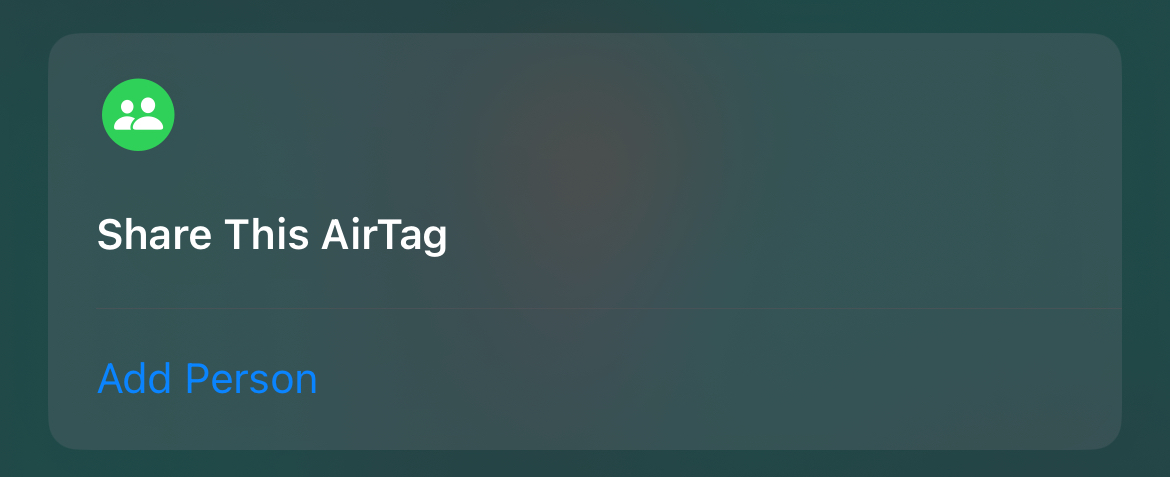

I don’t know if I dreamt it, but I thought that with iOS 17, they were going to release an update where you could share air tags. This is an oft-requested feature and would suit your needs perfectly. Here’s hoping…
  • Love
Reactions: dexterie
It’s no dream! Just note that both people have to be on iOS 17 (Or presumably iPadOS 17). I shared to someone not using the developer beta and it doesn’t show up for them despite being added on my end.

FYI, iOS 17 does have a way to share an AirTag so my wife can take my keys, for example, without it activating the anti-stalking features. But both phones must be on iOS 17 and the recipient gets notified that the sharing is offered.
