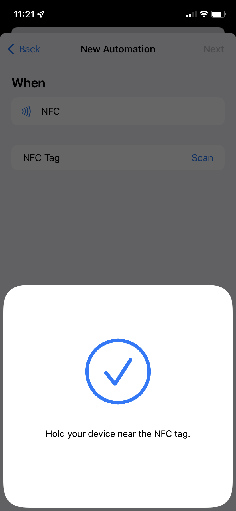

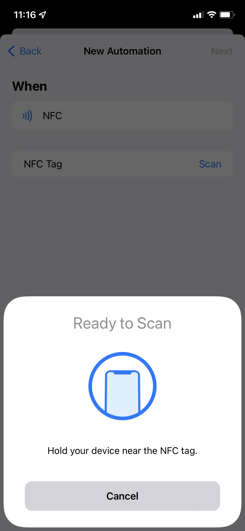

I've set the Automation with AirTag as NFC trigger. When near activate certain Focus.
But it's not working. Also, I need to scan the airtag for almost a minute for the first time to create an automation. Using iPhone 11 with iOS 15.1.
Anyone else experience similar issue? I'd really like to use it also as an NFC trigger.
p.s.: I can add the airtag instantly to FindMy, there are no issues
I've removed the automation and trying to recreate it again.
I'm doing this:
And my iPhone is lying on the airtag.
After almost a minute I get this:
I've restarted the iPhone and pulled out the battery from AirTag and put it back in. Same issue.
Any help or guidance is welcome.
Ok, it works... I need to scan the white (plastic) side of the airtags, not the metal part. Doh!

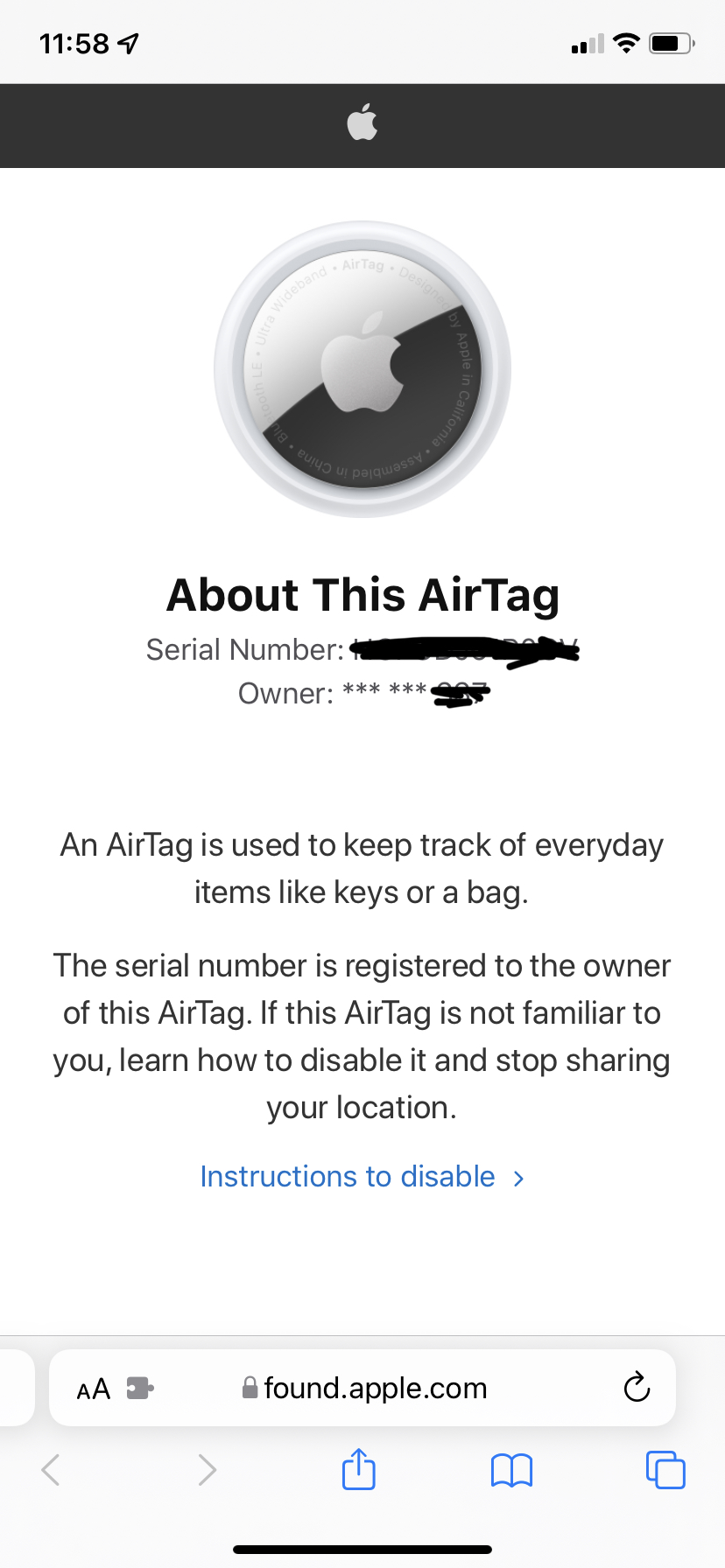

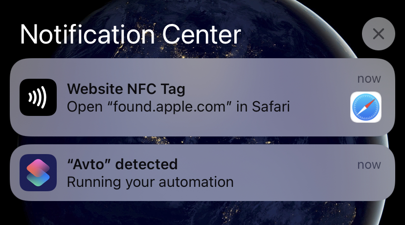

Ok, next this. Not the NFC is working with airtag, but when I scan it to active my automation, I always get this notification:
Website NFC Tag?
When I go to this website I get this:
And I get this every time I scan the airtag.
