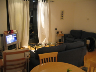

When airtunes is in the longe (15 ft from mt mac) it blips now and again.....when there is movement in between in mac and the airtunes......and sudden movement for say 5 seconds, it stops and starts, i sit down, and its fine. I then plug aitrunes in the same room as my mac, move around like a nutter and it is fine. What on earch could be causeing this bad interference (me simply moving) when it is only 15ft apart?
I finally realized what it was when i was listening to music with no blips for an hour or more, then my house mate walked into the room and immediatly is started to blip he then sat down and it stopped, then as a test he chucked his bag on the sofa (which is in near the wall that the music would pass through) and it blipped again.
Are there any thought on this....Please
To give you an idea how small the space is, the airtunes would be on the same wall as the TV (left) and the mac in behind the wall on the right)
