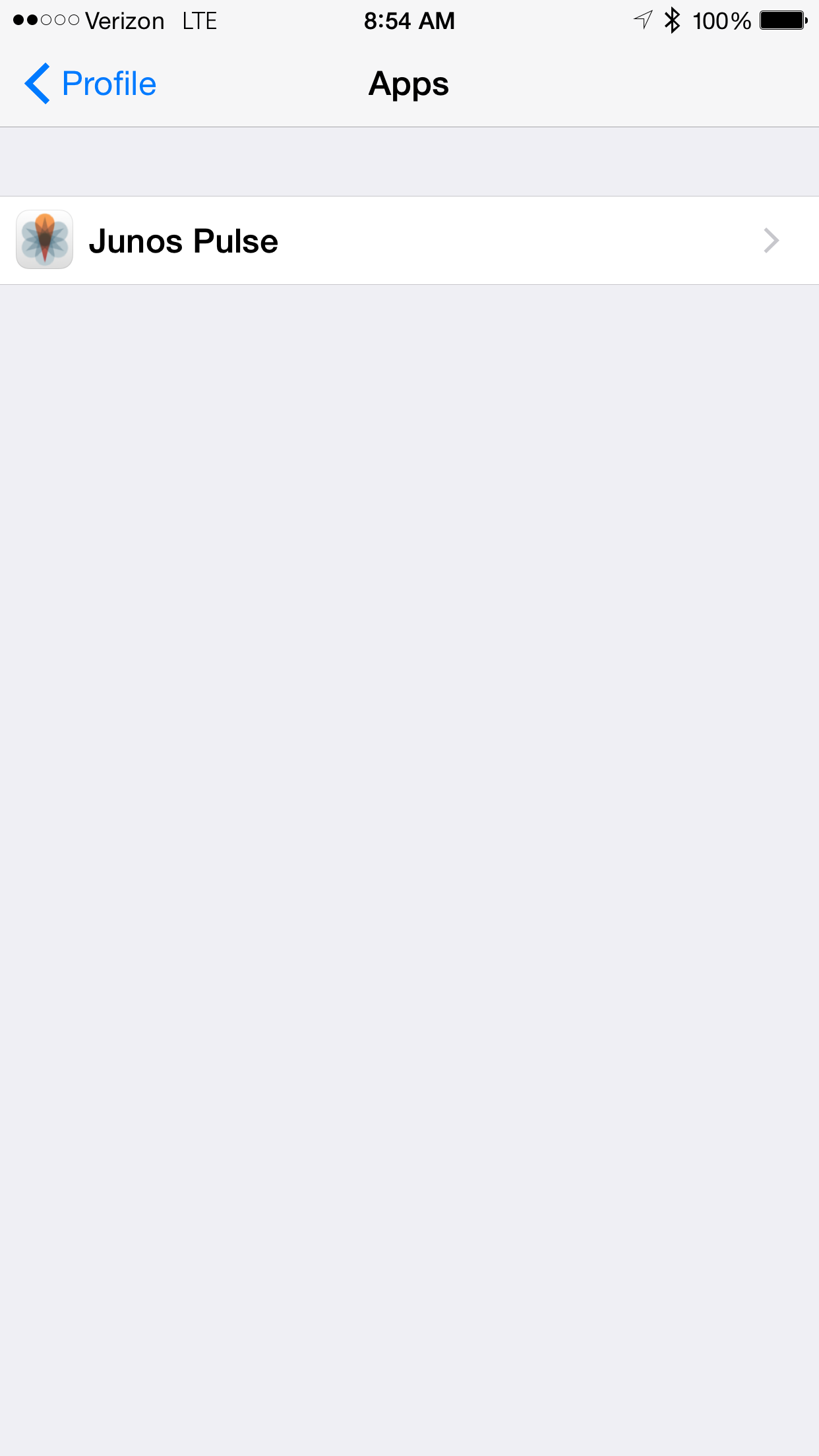

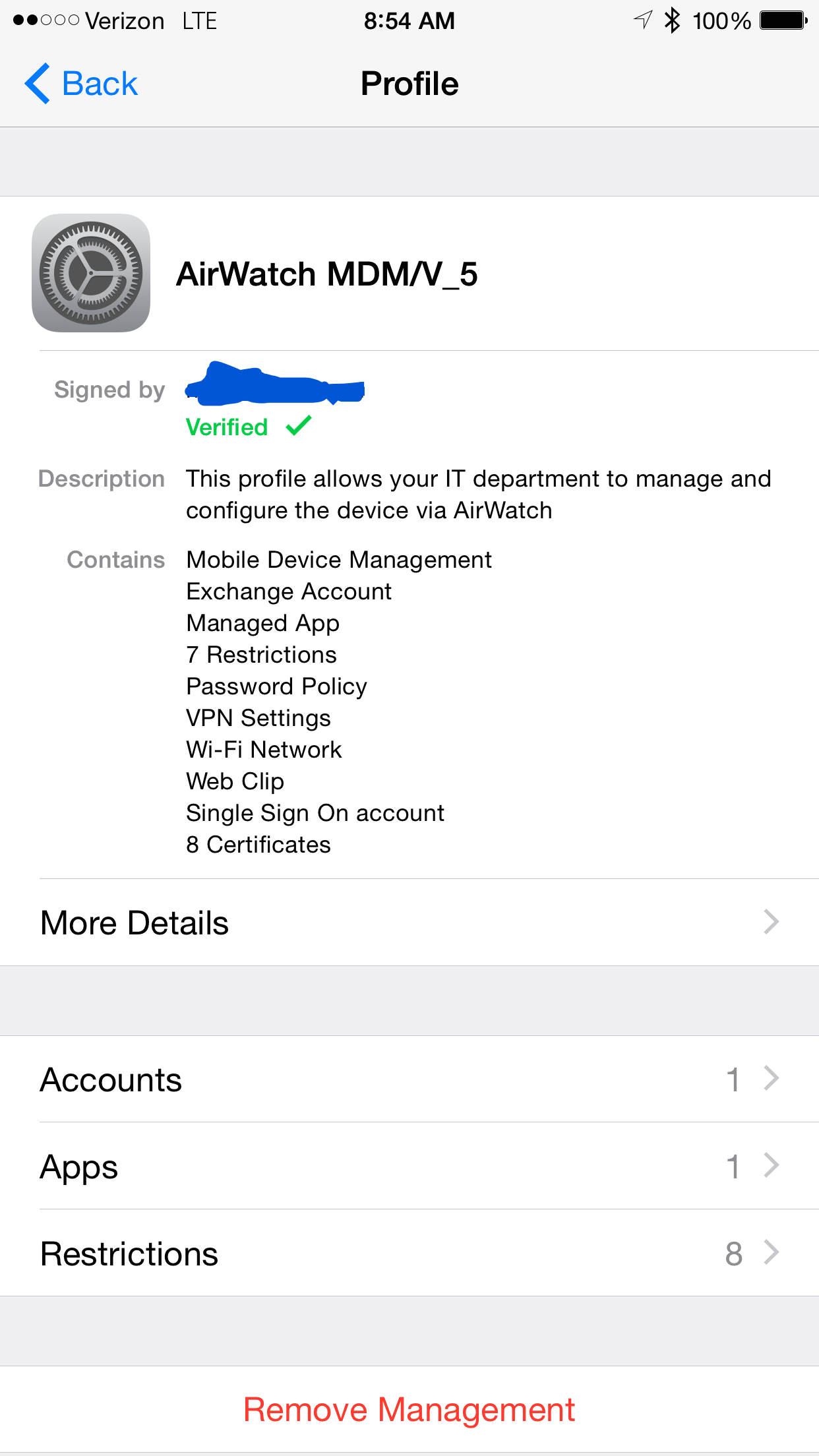

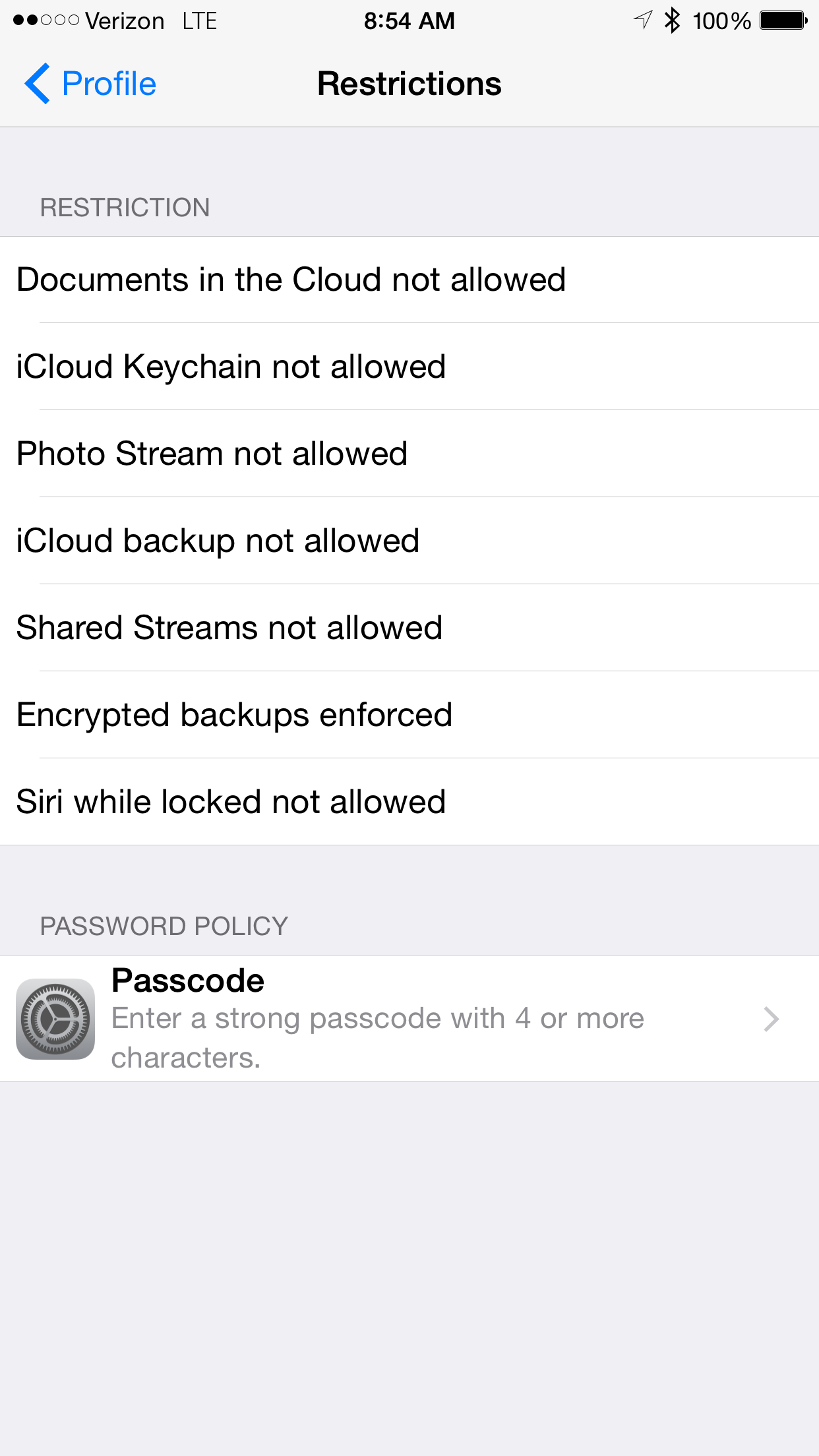

From what I am reading maybe the issues are Airwatch profile specific. Attached are my Airwatch profile settings.
