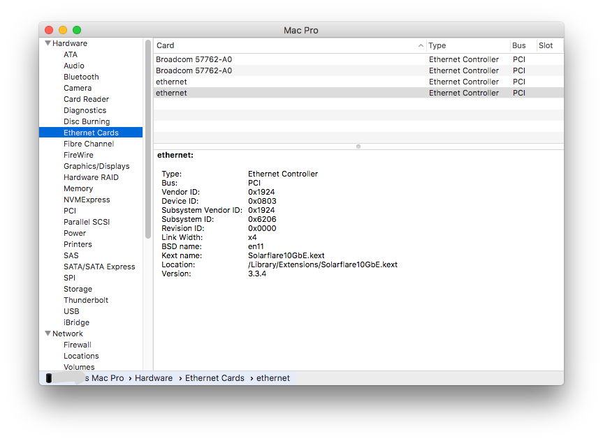

But the SolarFlare worked!
At first I just placed the NIC into the Thunder2, connected the Thunderbolt2 cable and power and just wanted to see if macOS would detect it without doing anything else. No joy.
I headed to the support website and downloaded the drivers
Solarflare OS X Driver Package [OS X 10.9 - Signed]

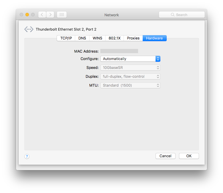

Installed the drivers and restarted the Mac and right after boot up it was there. 2 new Ethernet ports @ 10Gb
At the moment I just have it connected to a 10Gb switch and plan on getting the file servers switched to 10Gb this month when I get the time.
So outside of a speedtest and just trying a file transfer, which nothing went over Gigabit speed at the moment but I was just more so excited that I didn't have to drop $500 on a similar setup. This little project came in at $263.
