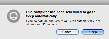

I must be missing something. I just tested that scheduling. It successfully put my MBP to sleep on schedule (actually, with a 10-minute delay), then woke it up successfully 5 minutes later. When I tried it with shut down/power on, it successfully shut it down (again with a 10-minute delay), but it did not power it on.

Restarting worked fine on a mini running SL, but not on the MBP running Leopard. On both systems, whether I choose sleep or shut down, this is what I get at the scheduled time:

EDIT: On Leopard on the MacPro the message says it will 'SHUT DOWN' in 10 minutes'.
