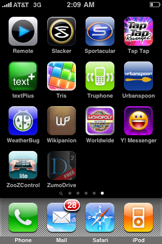

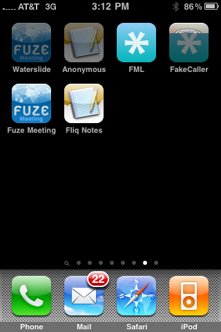

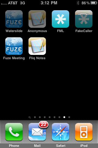

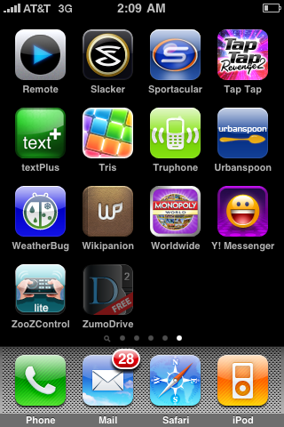

icon bug
I put the applications with the wrong icon with the ones that have the correct icon.
