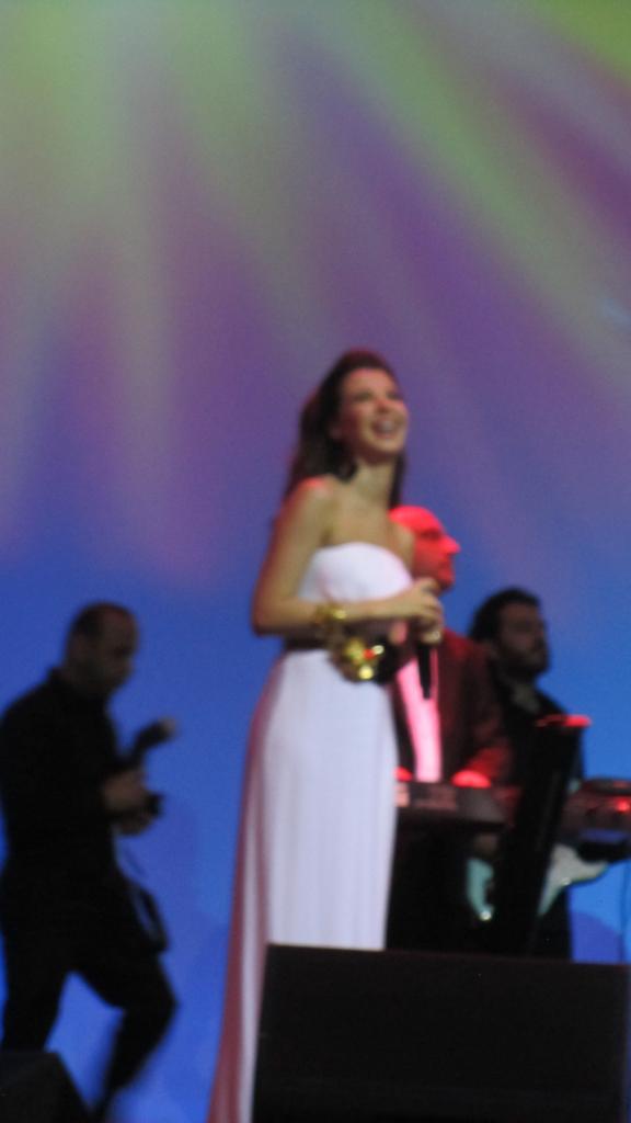

Here are two pics for examples...the first is when I first got the camera. The second is how it is now. Now I realize the second one isn't the best shot (in terms of position and what not) but it is exactly how my pics are coming out. There is no zoom and I was as still as humanly possible.

Oh dear. That is quite out of focus. If you haven't accidentally set the camera to manual focus I suspect something important has given up the ghost.
I would try and get a tripod (even a mini desk one) to rule out camera shake. They are pretty cheap.
To my eye, even the first shot is not incredibly focused. Try the tripod of a still subject (fruit or something) in really good lighting. Set to auto and reset the camera settings. If the focus is still of then the camera needs a trip to the shop.
Yeah it is, and just imagine I took that shot several times. 🙄
I want to avoid repair or anything like that. It's out of warranty so I'm sure it will be very expensive to fix it. It would be a better option to replace it. But still it's a 4 year old camera, it kinda sucks replacing it. 🙁
Just guessing but maybe it doesn't focus anymore. Probably something broke. Try focusing with your feet. Try taking a picture of a wall from different distances and see if you can find where it is focusing. I'll bet it always focuses at that same distance.
If you can find the focus distance and get a clean photo then at least you know the lenses haven't been knocked out of alignment.
With this knowledge in hand you can search around and find someone to give you an estimate on the repair charge.
You've probably already done this but have you checked the battery? A four year old battery might be going bad. Perhaps there is not enough power to drive the motor properly? Looks like you can get a replacement battery cheaply online.
