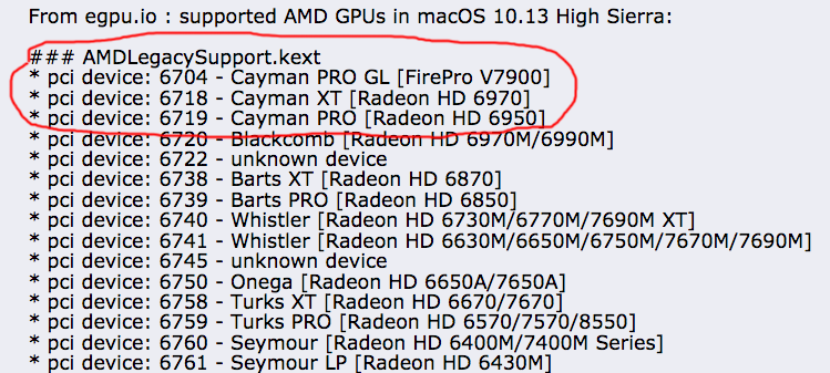

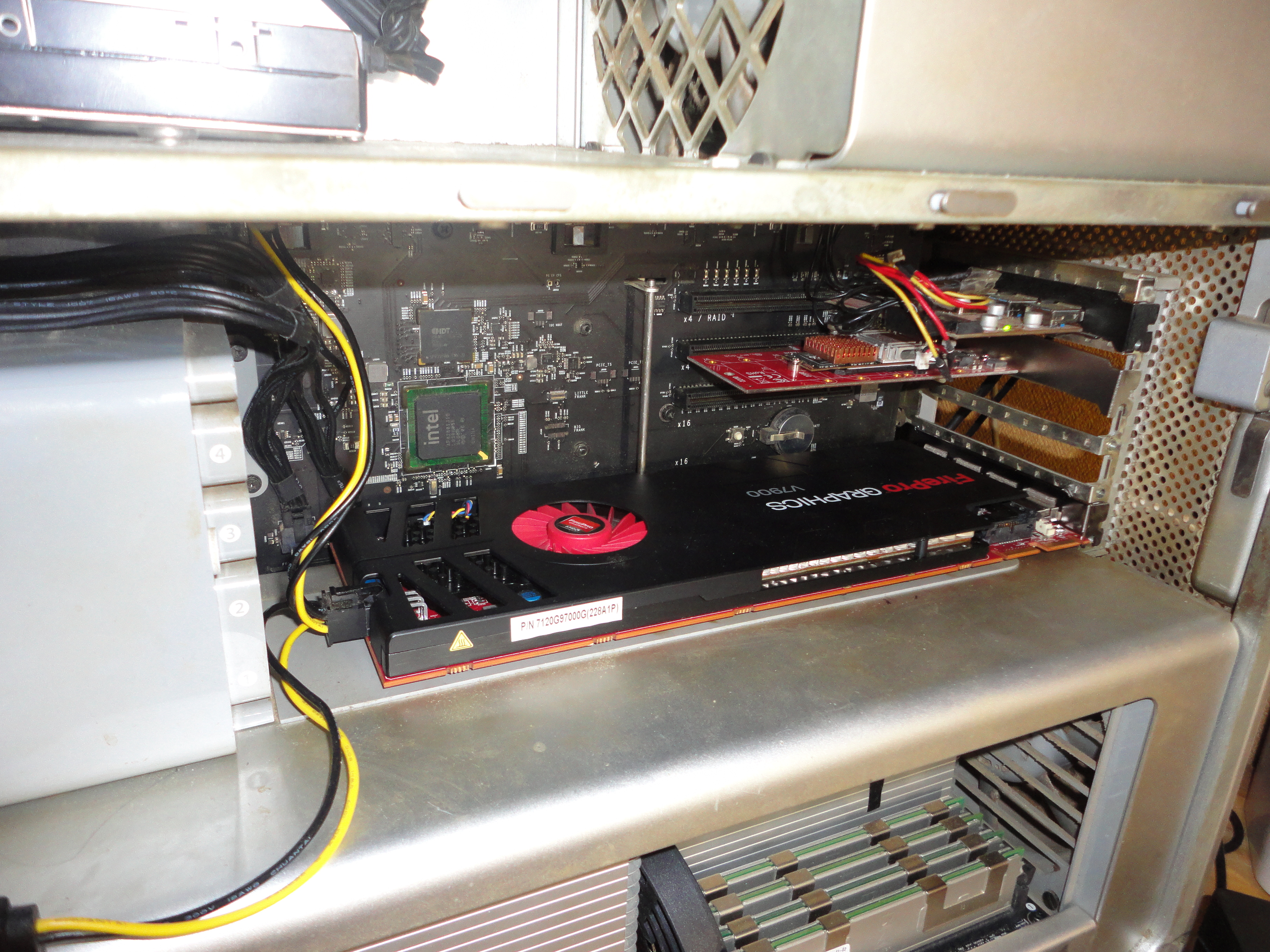

Bought a cheap, used FirePro v7900. 2 gb 4 x Display Port here in Japan today because it is a single PCIe slot and only one 6 pin for power = would be a useful adjunct for flashing other cards in Win7 ( 6 pin ).

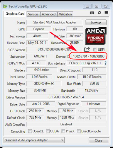

It's device ID is listed in Win7 GPUz as 1002 6704 and also the same in High Sierra's AMDLegacySupport.kext so I expected that using ACTIVE DP to DVI adapter that it would boot into High Sierra 10.13.6.
Tried DVI to DVI. & DVDI to HDMI cables with the TWO active adapters I also bought.
TDP is 150w. I tried BOTH ( 1) 2 x SATA to 6 pin &. (2) 1 x cMP onboard mini 6pin to 6 pin with no luck.
It DOES boot into Win 7 but after installing the AMD Catalyst driver it is still showing as GENERIC GPU in GPUz.
Does anyone know which equivalent 6xxxx AMD card the FirePro v7900 is based on ?
eg : would flashing the Cayman 6970 or Cayman 6950 rom with this FirePro v7900's correct device ID 6704 get it booting in HS ? EDIT The reference HD 6970 has 2 x mDP. . . I would be happy with one mDP working ( no EFI ).
Seeing that I've seen vids of other FirePros running in cMPs .. this one SHOULD run in HS too.
Any advice, suggestions, ideas gratefully appreciated.

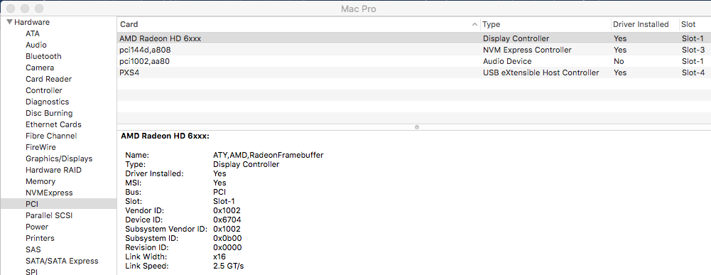

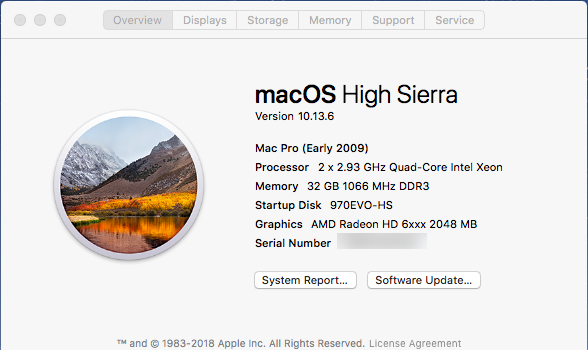

SUCCESS. . kind of . .the two "ACTIVE" Display Port to HDMI adapters I bought didn't work with the FirePro v7900 but I had a "made in Japan" DP to HDMI adapter lying around so I tried it . . .
FirePro DP to Japanese DP-HDMI adapter to HDMI DVI to DVI to monitor.
it worked but it looks as if the cMP booted up in Safe Boot .. .
This is not a fast card but it is a SINGLE SLOT card + only requires ONE 6 pin for power = useful spare and will come in handy when I EFI flash my soon to be bought R9 280X.
EDIT : No bootscreen of course but it could be that the HD 6970 rom with the FirePro's ID might work. . time will tell.
EDIt #2 Actually the purchased ACTIVE DP to DVI DO work .. . it's just tha tbootup time is longer .. about one minute.

As it stands the Firepro v7900 is working in High Sierra; un-accelerated, boots into Safe Boot always despite my running " sudo nvram boot-args="" in Terminal.
Glitches when moving some apps GUIs. Slow.

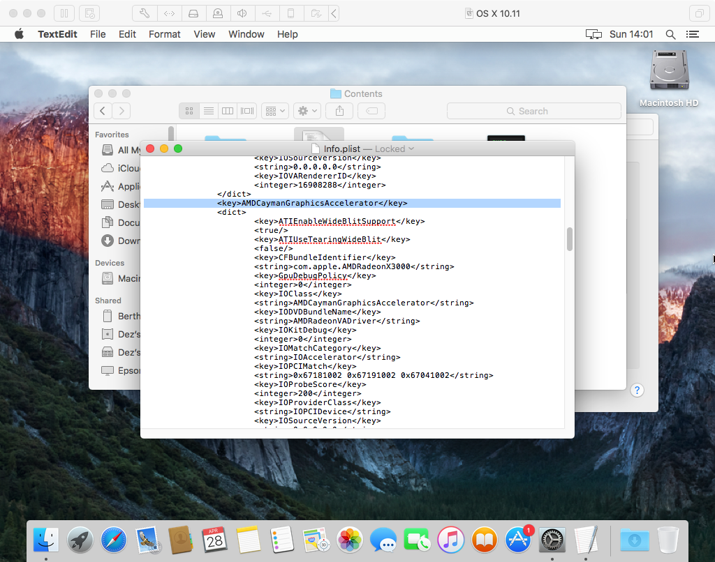

Ok I see the issue, the entire Cayman section from the X3000s plist has been removed at some point
Im not sure when Apple removed it, but its there in 10.11.6,
you might be able to add the section back but its not something iv tested
you could also try 6704 to the Barts section but that may or may not work and you may not have all the GPUs compute units enabled

you could try add it to the "barts" section of the X3000 kext but again this is untested
(if you look at the kext, inside the plist is sections for each type of GPU, and at some point after 10.11.6, apple removed the Cayman section hence why you have no graphics acceleration)

Did a clean install of El Capitan 10.11.6.
Both the El Cap. AMD6000Controller.kext & the AMDRadeonX3000.kext list the FirePro v7900 ( ID 6704 ) but no matter the connection to an iiyama monitor eg: DP to active adaper to HDMI or DP to active adapter to DVI = no boot up at all, in fact in El Cap. my 4,1>5,1 goes into a re-boot cycle. I tried all of the 4 Display Ports too and also tried booting with two monitors connected.
