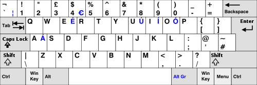

It appears to be on the tilde key on the right hand side.
That isn't a UK Apple keyboard.

i think that's a pc keyboard...
my @ key is shift+2 and the tilde key is next to the z, the hash key in the diagram is \ (or | with shift) in my keyboard
