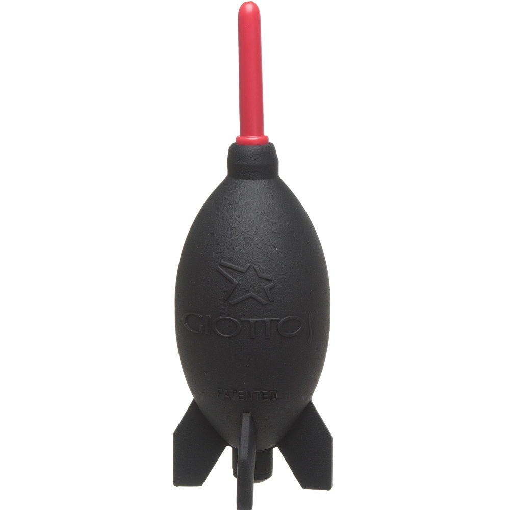

If you have a camera shop nearby you might be able to find one of the Giottos Rocket Blaster Dust Removal Tools. Just squeeze the bulb.
They run about $12 USD
Is that thing powerful enough to clean the dust off butterfly keyboard?
