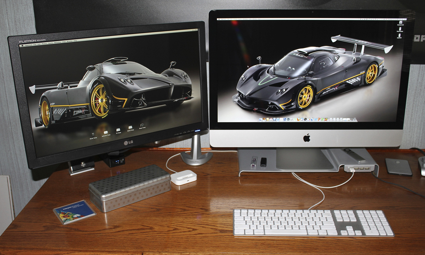

I'm using a LG Flatron W2442PA as a secondary display attached to my 27" imac via DVI and it looks pretty good, but anything other than a apple display next to the newer imacs IMO looks like a lower quality picture.
and no, that's not my car . . .
um, that's a 24" 1080p TN panel, no surprise there..
