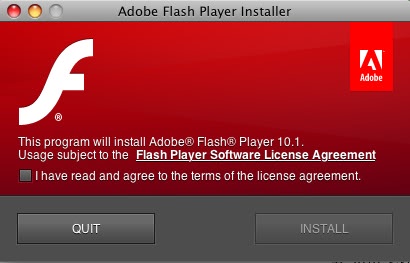

If it's not working in Safari, and just to clarify, when you double-clicked on the installer, did you get this:
Did everything seem to go okay with the install?

Flash installed, showing the sliding bar as you illustrated. It concluded successfully with the message: Finished.
