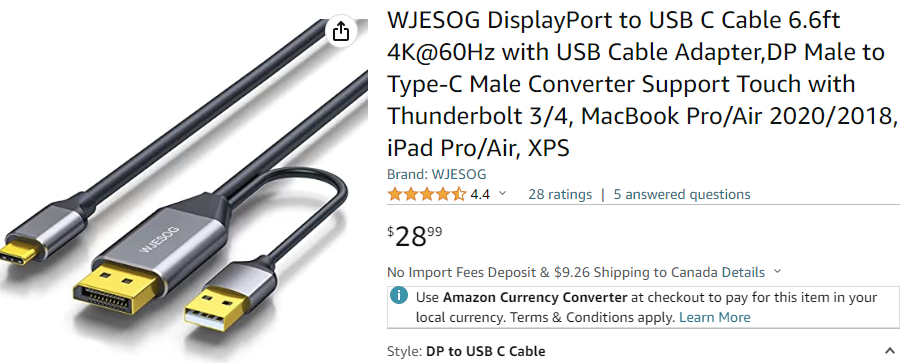

The cable made by "WJESOG" is on Amazon here for US$30. Make sure you get the "DP to USB-C" version.

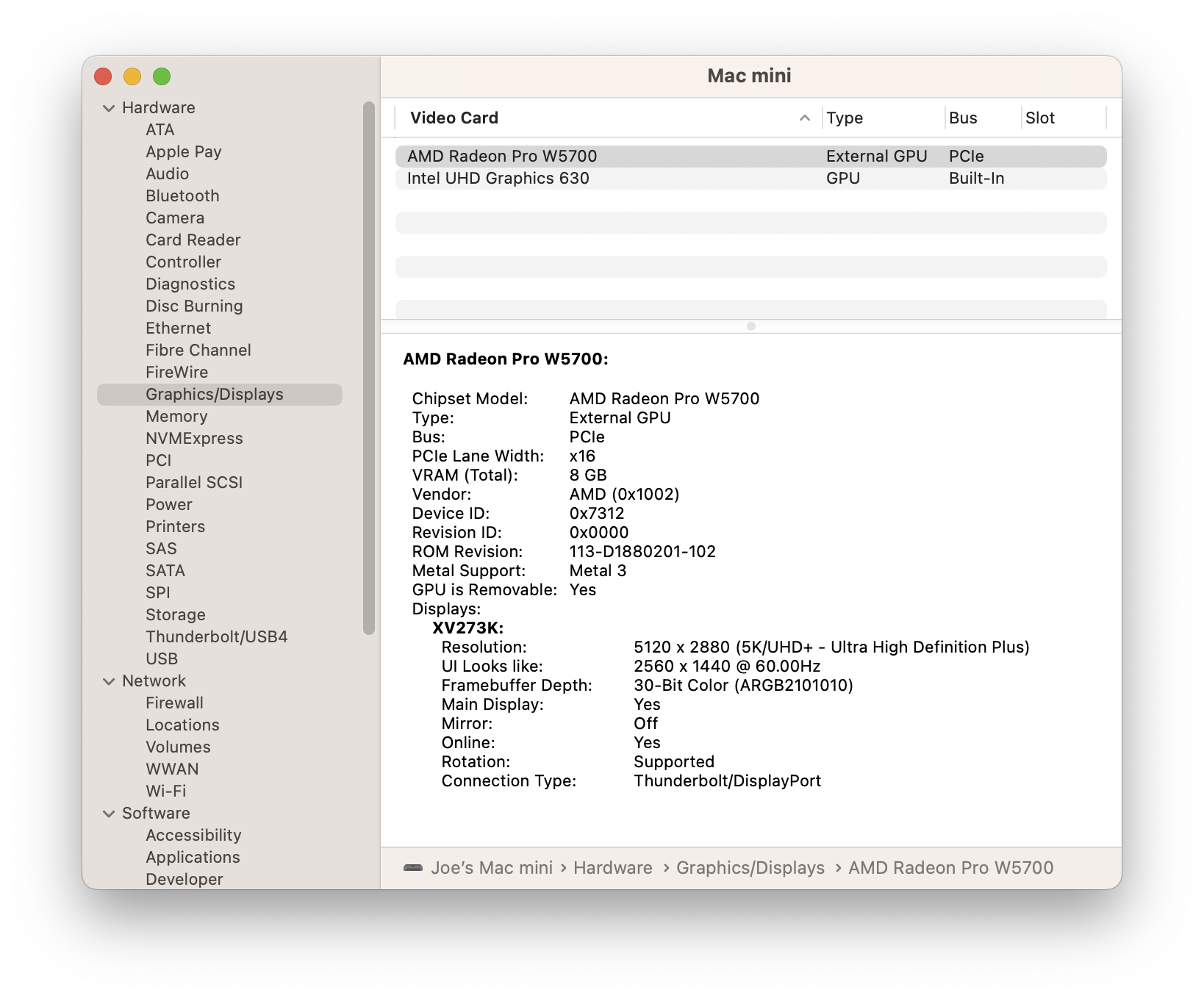

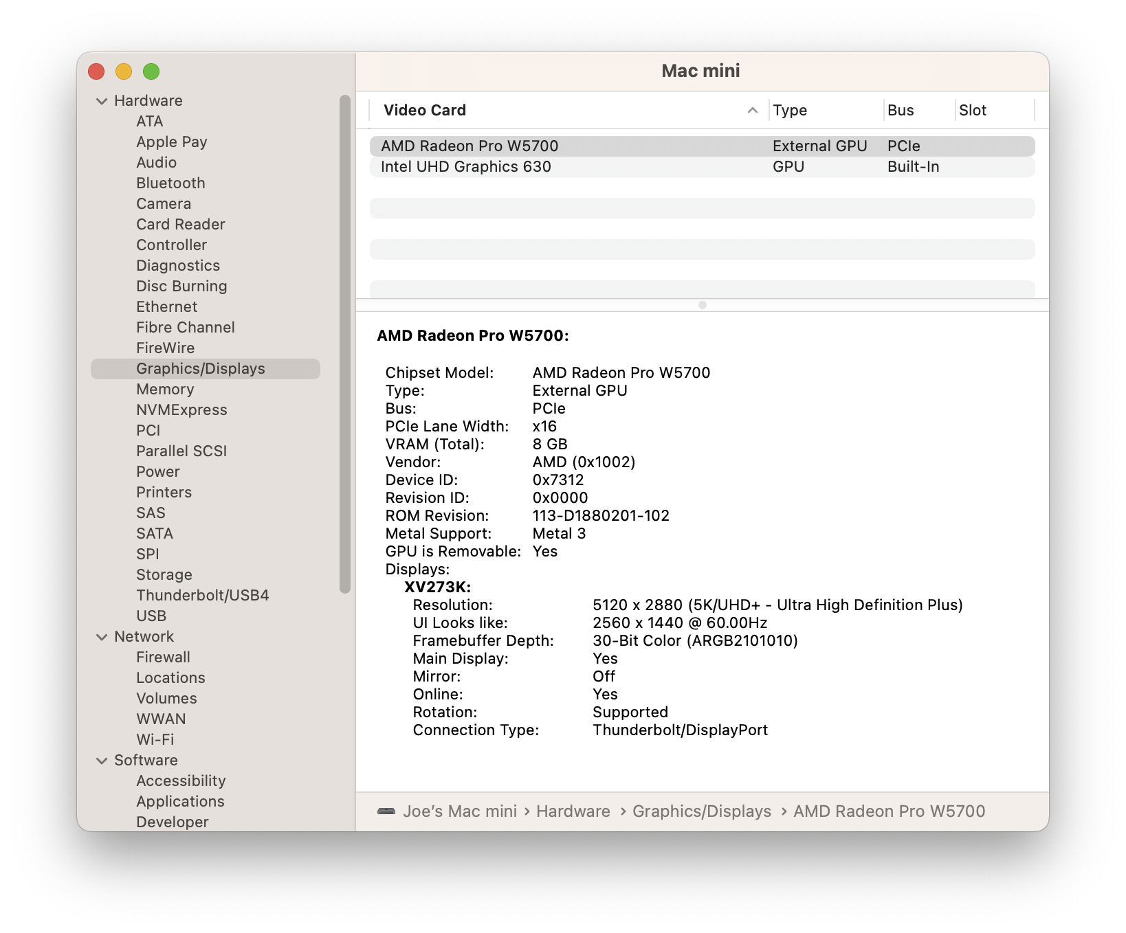

The AGDCDiagnose output is not the real resolution. Your real resolution can be found in About this Mac and then the Display tab.
joevt
Contributor
Jun 21, 2012
6,848
4,137
You got that backwards. The Display tab shows the frame buffer resolution. The output resolution is not shown by macOS except in AGDCDiagnose output or SwitchResX timing info or AllRez timing info.
In this screenshot, it says 5K but my display is only 4K and the display shows 4K in its onscreen menu.
Reactions: DrEGPU and arw

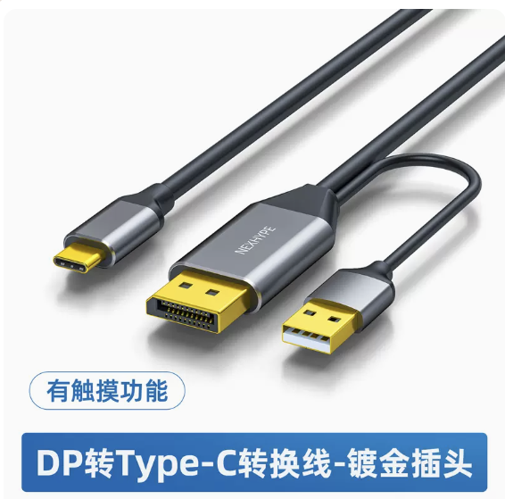

Somehow, the internet bought me here.
I'm in a similar situation; I have a DAN A4 SFX build, and I'm trying to find a cable connecting between 3070 to XG16.
Amazon.com has this cable in stock at 2 am EDT on April 27, 2023
And after I searched the internet and even found an upgrade version of the WJESOG cable, the only issue is that it was not listed on Amazon.com yet. They are available on Taobao at the moment.
The WJESOG cable (that supports the Portable Touch Screen, e.g. ThinkVision M14t)
The cable supports a Portable Touch Screen and Power Delivery.
With two different ends.
Hopefully, one day these cables will be listed on Amazon.
Good luck, and enjoy your 4090 build.

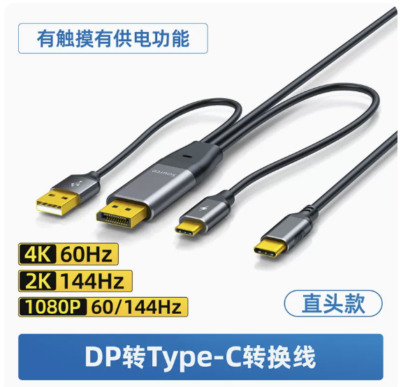

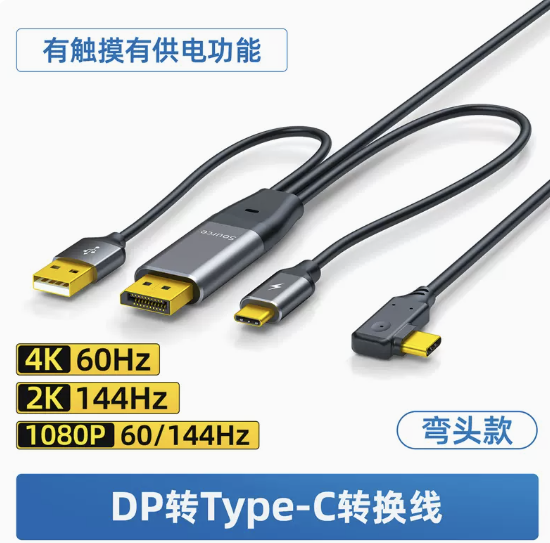

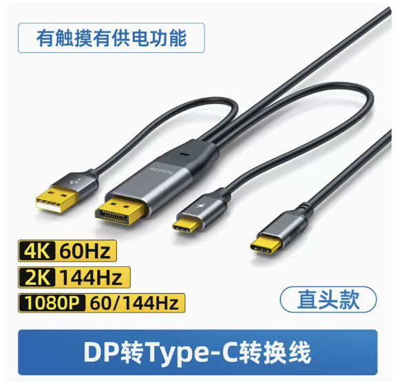

View attachment 2194254 View attachment 2194251
View attachment 2194252 View attachment 2194253
