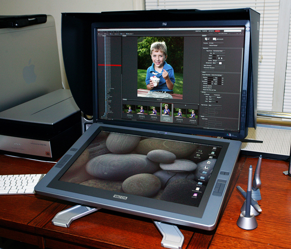

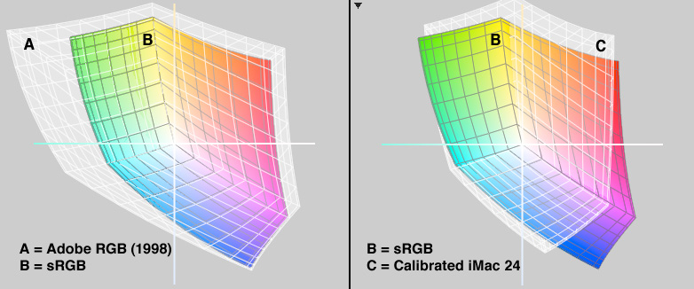

Proofing displays and color gamuts
Ah, see I wasn't sure about LaCie... I'm more familiar with LaCie's spectacularly unreliable external storage products.
Agreed. I was the recipient of one of such external devices, which is now a door stop. Fortunately, their monitors have a better reputation. The LaCie 14-bit 700 series LCD's are capable of displaying up to 125 percent of Adobe RGB gamut. The 12-bit 500 series is capable of 97 percent of the same gamut.
During calibration classes for monitors and large-format printers, EIZO and LaCie were the two most highly regarded brands by neutral parties. These two come with the best integrated hardware/software calibration systems. Unsurprisingly, at one color management event sponsored by HP, the Dreamcast was discussed and demonstrated.
There are several RGB color spaces. Apple Aperture uses Wide Gamut RGB. The goal is to use a monitor that can display the same range of color as the output device. If, for example, the printer is calibrated for Adobe RGB (1998), the monitor used in the production setting should be able to replicate that range. A monitor limited to sRGB is only capable of reproducing a fraction of the Adobe RGB color space.
The professional color proofing monitors I mentioned include tri-color RGB LED backlights and are capable of displaying most, if not more than, the Adobe RGB color range. Newer consumer-grade Dell monitors offer this option. High-end HP printers are optimized for Adobe RGB, to match traditional prepress workflows. (Note application-managed color can also be enabled on high-end HP printers.)
