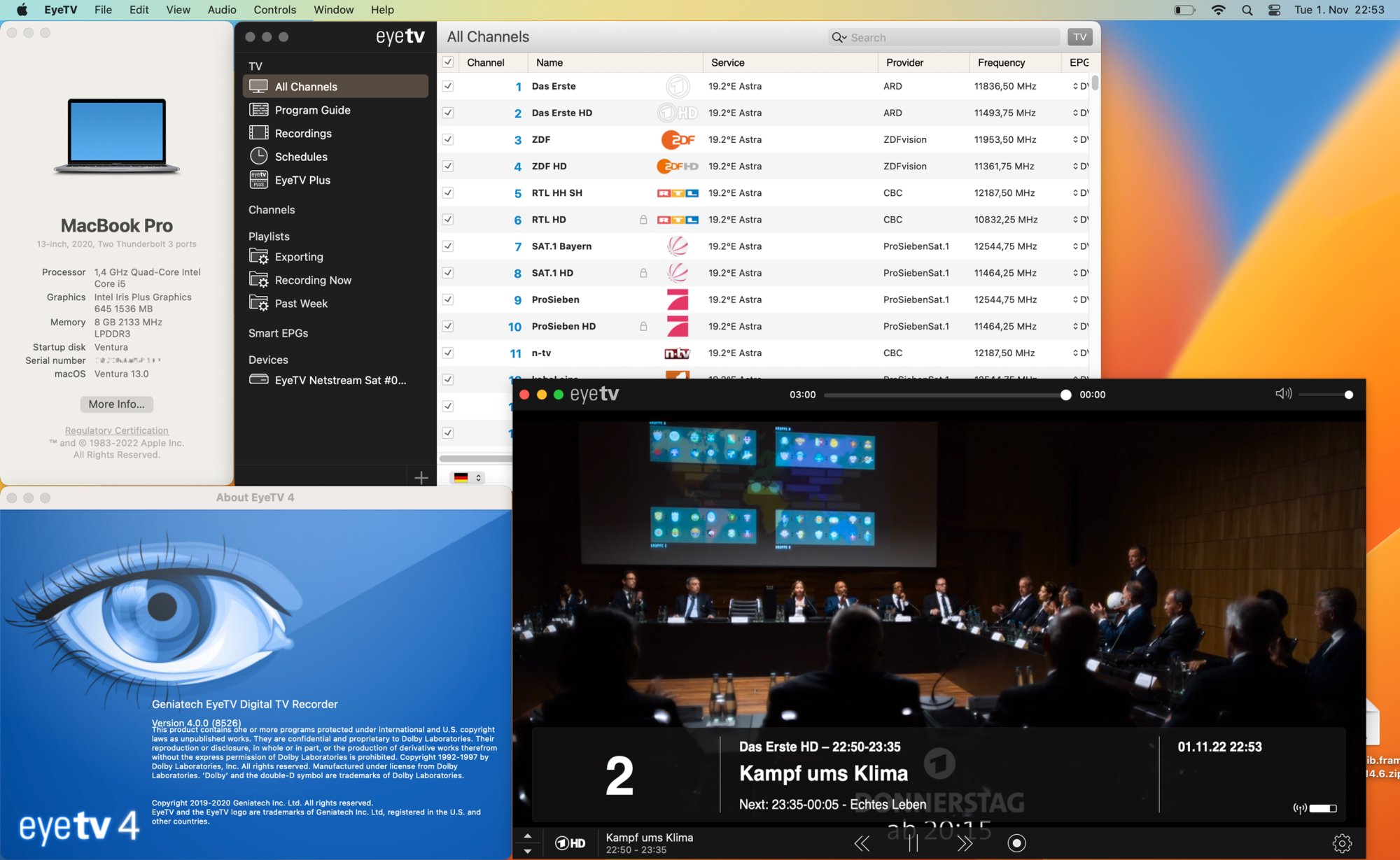

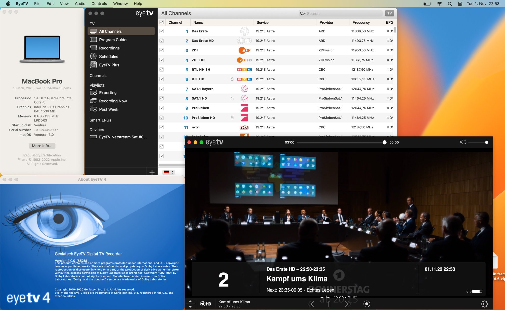

Btw, I had a similar experience as @pc297; with all recent EyeTV4 releases I had problems like stuttering and every 2nd frame dropped until Geniatech sent me an old 4.0.0 (8520) which finally has smooth motion again and is stable (EyeTV Sat Free & EyeTV Netstream Sat).
Reactions: Lycestra

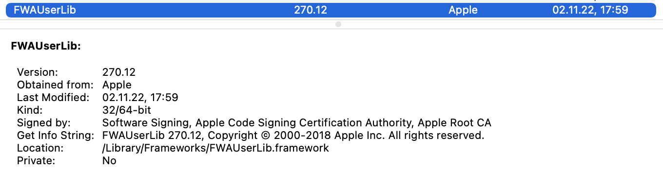

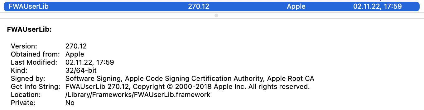

You're right, although being from Mojave, on Ventura Intel the signature is valid:
