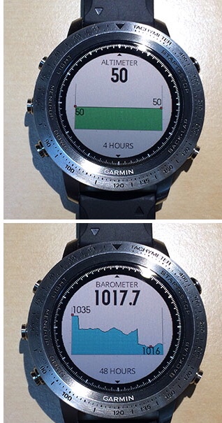

Do any of them function similar to Garmin Fenix where it charts changes over time?

Would be nice to have something similar that simply charts altitude and barometric changes using the barometer sensor over gps. Both the Fenix, the gear s3 frontier and Casio do this and IMO is the only thing missing from the Apple Watch
I took a look at the interfaces Apple currently supports, but Altimeter data looks to only be available while an app is running on the watch. So unfortunately, Fenix like functionality looks like it can't be done standalone on the watch with the current Apple APIs. It would be possible to pull that data from the phone, I believe, but might require a background app running there as well (I didn't look in to that.)
