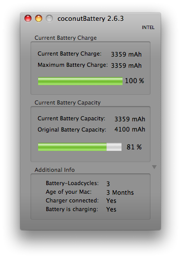

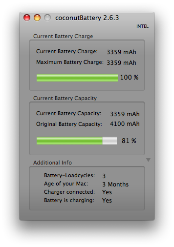

I just took a look at coconut battery now and attached a screenshot of what it's currently showing...
I'm guessing the health in here doesn't seem too good considering my old first gen 17" MacBook Pro isn't even this low and it's been through 150+ cycles. It also seems strange that coconut Battery is showing that the battery is 100% charged but not in the menu bar.

Yeah, that doesn't look too good for a battery that is only a few weeks old.
I'm pretty sure the 4100 mAh is the correct base number for the Alu. MacBooks. Although, usually brand new batteries rate even higher than the base rate.
I'd take it into Apple...they should give you a new battery.

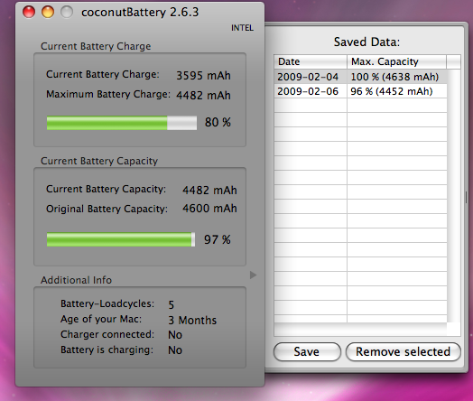

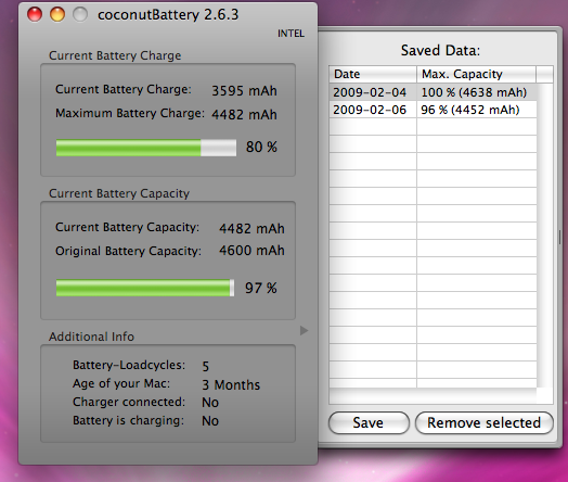

i have a new aluminium macbook pro 2,53.
to me happen the same thing 99% and apperars the green light at 99%.
i let discharge completly for 6 hours , than recharge again for 5 more 5 hours, and it sotps at 99% and the green light appear.
note my battery as only 5 cicles.
i install coconut
my original charging was 4600 mha
and now is only 4452 mha
but 2 days before this happen my charge was 4638 mha 100%
it 100% now
well after my last post , now the battery charges 100% and appers green, but coconut shows
maximum battery charge 96%
original 4600 mha
current capacity 4494 mha
What does system profiler show for the same information? If the light is green and the numbers match up, I would tend to believe system profiler before that app.
You have the firmware updates right? This was a "known issue" of sorts with the new aluminum Macs, my buddy's new MBP was doing this and 2 new batteries still did not help the issue. The updates did fix it for him, that and a good calibrating the battery seemed to solve it.

Thanks for all your help Kevin. I'll be sure to take it into Apple, as I was able to test my battery earlier in a friend's 2.0 GHz Aluminum MacBook and it did the exact same thing. I also tried their battery in mine and it was fine so it seems like it's definitely a problem with the battery and thankfully not the machine/magsafe.
KheeseKake
