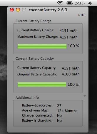

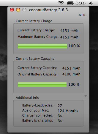

I was given 5hrs 20mins battery life last night when only running Firefox and Coconut now says:
Battery-Loadcycles: 2
Maximum Battery Capacity: 4269 mAh (which is slightly up from yesterday)
Original Battery Capacity: 4100 mAh
(I'd check how long it'd give me now but it's still charging.
5000 mAh? Wow, we're a bit off then! Is that after a few calibrations? Haven't calibrated mine yet.
Thanks for the heads-up.
Charge Information:
Charge remaining (mAh): 4151
Fully charged: Yes
Charging: No
Full charge capacity (mAh): 4151
I am given 5:33

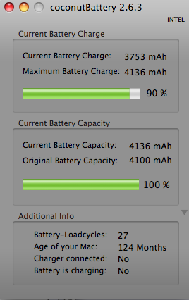

Not too happy about my numbers right now, the capacity goes anywhere from 94-96%. I've calibrated about 5 or 6 times but the capacity seems to drop after each calibration.
That being said, I can still squeeze around 4-4:30 hours consistently out of my battery. I guess if it suddenly gets worse or drops below 80% capacity, I will take it in.
My advice to those of you who have a capacity over 4100 mAh is to be happy.
(2.14 ghz unibody purchased in October)

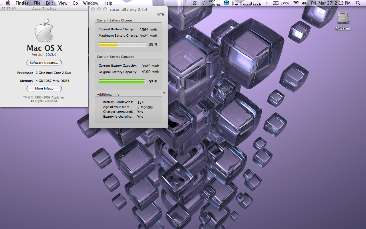

My MBP's battery has been playing up recently. The last few days it was only holding an hour's charge. I drained it and recharged it last night and now it's up to 1 hr 20 mins- this is after I turned off the keyboard backlighting, and the screen brightness to 3 notches from the top. Wifi is always connected.
Here are my coconut battery results. Perhaps it is just old and time for a new one? I have never got 5 hours like some others in this thread; 3 or 4 at the most. I usually have mail, safari, itunes/vlc open.
All opinions appreciated.
Melissa.
